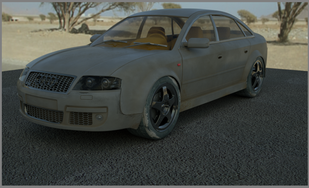

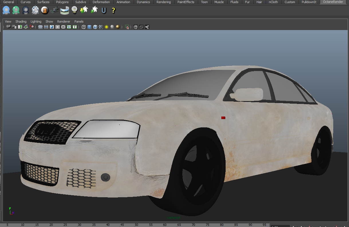

i've been using octane standalone demo for a while and it works fine, but recently i got the maya demo but my textures are not being rendered correctly
The viewport render and the standalone renders are ok.

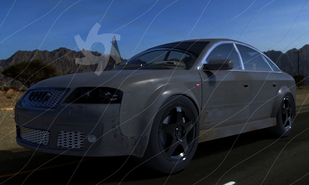

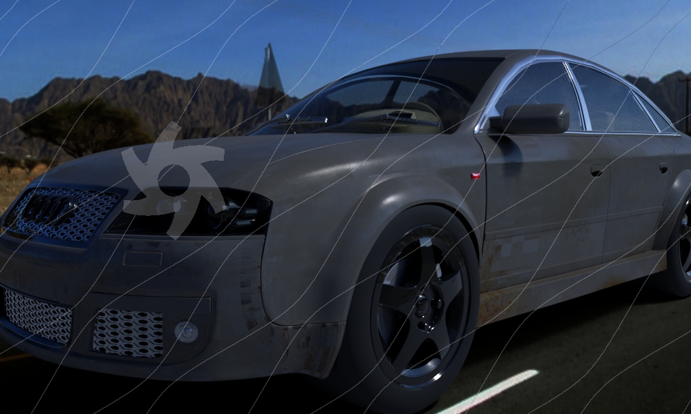

But when i do render with the maya demo plugin, the textures are not rendered correctly. see below
Anybody with a solution please help.

The first thing to do is double check your normals and also scene scale (to large or tiny models can cause problems). You can use octane's deep channel kernel to help with this - to see if octane is being provided with problematic normals.
