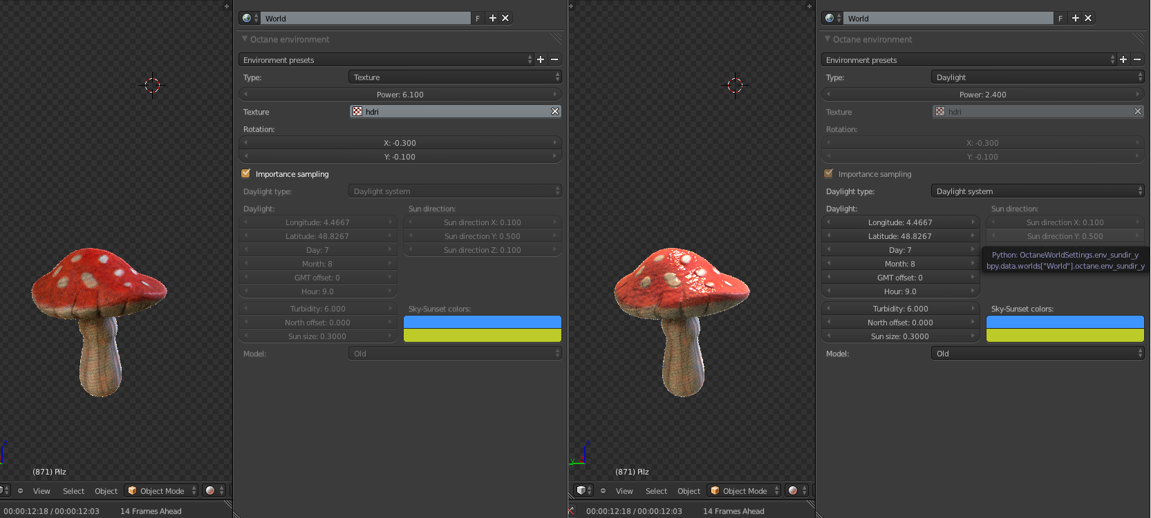

Is there a way or an option to combine the light information of an Hdri with the Daylight ?

Hi myclay, it is not possible to use features in Blender the Standalone not support.
