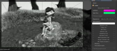

I wanted an unsaturated image with stereo in it and the 0 Saturation is killing the Stereo.
Could there be a check option to let the Stereo ignore the changes of the response type and other settings within the camera?
