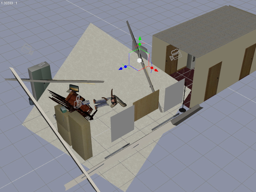

Since installing Octane Plugin I noticed that when I press the Scroll Lock key my loaded scene in DAZ studio gets irreversibly damaged.
Basically any jointed geometry loaded in the scene gets twisted and turned and there is no way to undo this change.

hi! this is definitely my bad.
this was implemented way back, even before the closed beta... it was meant to work as eye-to-cam pointer; since the point-at in ds3 didn't work all to well (like missing updates when switching keyframes), and since it caused (and still causes) crashes if pointed-at cameras are deleted through the daz api, it should serve as a better replacement. as it got rather useless with ds4 and genesis, i just had forgotten about it
what it does is to take all current selected nodes, look for bones that names ends with "eye" and points them to the camera. so i'm still a bit puzzled about what it does to your scene... if you like you can pm me the scene, so i can look what is the cause (maybe ik and/or other point-at relations), but imo it should be taken out completely...

Basically it happens even when I have clear scene and just add any character to it... Default Victoria 4, Genesis whatever... After pressing the Scroll Lock the figure gets mangled...
Check your PMs the scene file is there... It is a basic empty set with just the default Victoria 4.
