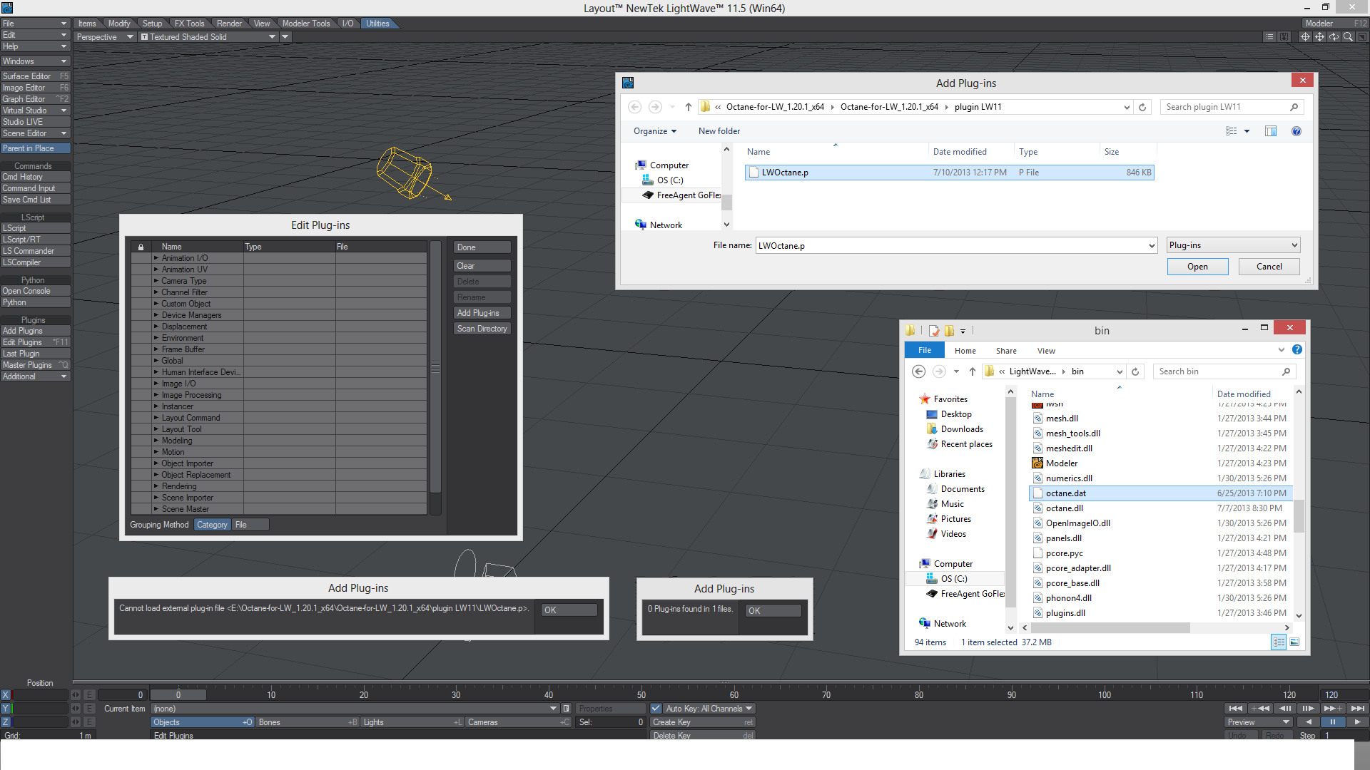

I tried Octane-for-LW_1.20.1_x64_demo and got the same result.
I uninstalled Lightwave and files related to the Lightwave program, even in the registry.
I reinstalled Lightwave 11.5 x64 and Octane-for-LW_1.20.1_x64 and still got the same result,
the Octane plug will not install. Here is a screen grab showing my results.
I am sorry about this. Really I can't understand what could be the problem ... nobody reports a problem like this one
In the screen grab I can see that all is OK. A LW 11.5 x64 and the x64 plugin.
Do you have Skype? ... perhaps we can open a online chat to try to fix this really strange issue. My skype id is juanjgon71
-Juanjo
-Juanjo
