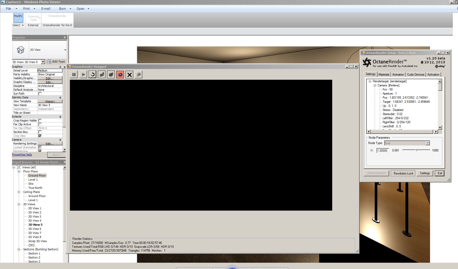

When I use the plug in to start octane the octane view port is totally black.
The camera is not inside a wall...I checked
I can render in revit using raytrace or mental ray.
any thing I am doing wrong??

Yes, this is happening in one revit file.
What does the Viewport statistics show - is it rendering (ie. the samples increasing), and are there a non-zero number of triangles and meshes? Could you pls post a screenshot of the Viewport (incl the statistics part of the window pls)?
Also, which version and build of Revit? Which Cuda driver version are you on?

A screenshot of the blank viewport would help a lot - showing all the statistics in the bottom panel.
If it's an interior scene - you'll need some form of illumination. Either use daylight with some clear windows for the light to get through, or setup emitters (this should be done automatically, however your Revit emission materials may be setup in a way that the plugin is not picking them up).

Just to summarise....the issue is most likely...
a) No geometry is loaded into Octane (the screenshot of the view stats will help identify if this is the case), or
b) There is no lighting in the scene. Check the manual for info on this http://render.otoy.com/manuals/Revit/?page_id=79. Or
c) The camera is in a wall. The Revit near clip distance might be different to the setting in Octane, so try increasing the nearClip slider in the Octane camera. Also, click the Viewport camera navigation button (the camera) and navigate around the scene a little to see if you pop out from the wall.

Hi guys, sorry about the delay - but here is the screenshot attached.
Cheers,
JNDesign
face_off
Posts: 15805
Location: Adelaide, Australia
The scene has geometry and is rendering, so it appears the emitters are not setup correctly. I will look at the sample scene you posted.
