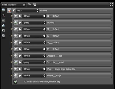

Octane currently working very good with multi materials without any need to do anything, below it's an example of an object with 10 materials assigned on every face ,with individual UV set and octane imports and works with them with ease.

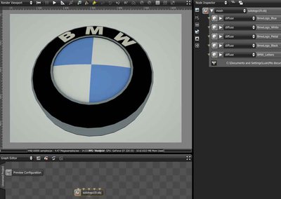

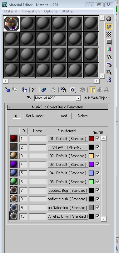

It seems there was a problem with the .obj export settings from another app, I tried again and yes it works... ah.....
EDIT: Ok, I found what was happening... This is a 3dsMax OBJ export limitation: if you have Vray Materials assigned to one or more slots, those materials will be converted to a single standard material and all the polygons Ids reset to 1. (read the image comments, since many of you are probably Vray users this may be of your interest)
In conclusion, some cleaning must be made in all multi-materials with one or more Vray Materials*... or use a script that the conversion automatically such as: http://www.motivacg.com/scripts/script01_en.html
*I guess this does not only happen with VrayMaterials but with other kind of material types...

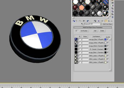

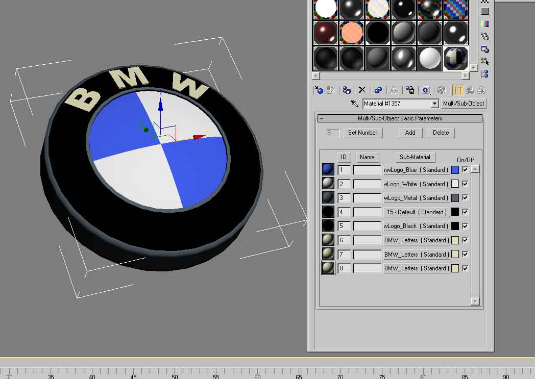

This is just a Max shot showing the multi-material with all the slots in Standard. (the right way)...
This is the -wanted- result... as long as we use standard materials in all slots everything is allright... One material per slot.

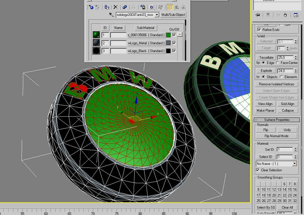

In this second example (next three images), Vray Materials have been used for the two center materials (blue and white logo), and the thee letters material...
When re-Importing the .obj back to max, we can see that what was before Vray Material is now a single green standard. The ids for these polygons are now 1 (the same for all)
This shows the result when imported to Octane... The Vray Materials are now one...
