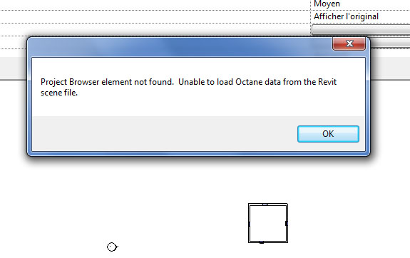

I use the plugin "OctaneRender for Revit 2014 Setup 1.20a beta"
it installs correctly, but window appears:
Then the plugin can only start if I'm on a 2D view and if I do not quickly pass a 3d view, relives crash.

The plugin saves the scene data against the "Project Browser" scene object. I suspect that on the French version of Revit the "Project Browser" has a different name. I will download and install French Revit 2014. In the meantime, could I trouble you to post a screenshot of your project browser window pls?

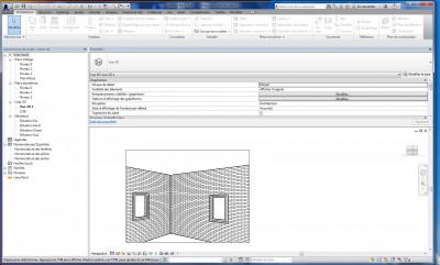

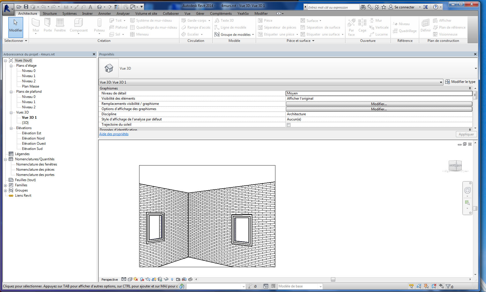

Here is a picture of my project browser (if I understood correctly)

face_off
Posts: 15771
Location: Adelaide, Australia
Thanks - it will take a while for Revit French to download. In the meantime I will upload a version which handles this situation better, and tries to get the Project Browser by the term "arborescence du project". Should be uploaded in the next hour or so. I will post here when done.

effectively, the browser is not found

face_off
Posts: 15771
OK - thank you. Installing French Revit now. Will have an update to you in 12hours. Sorry for the delay.
