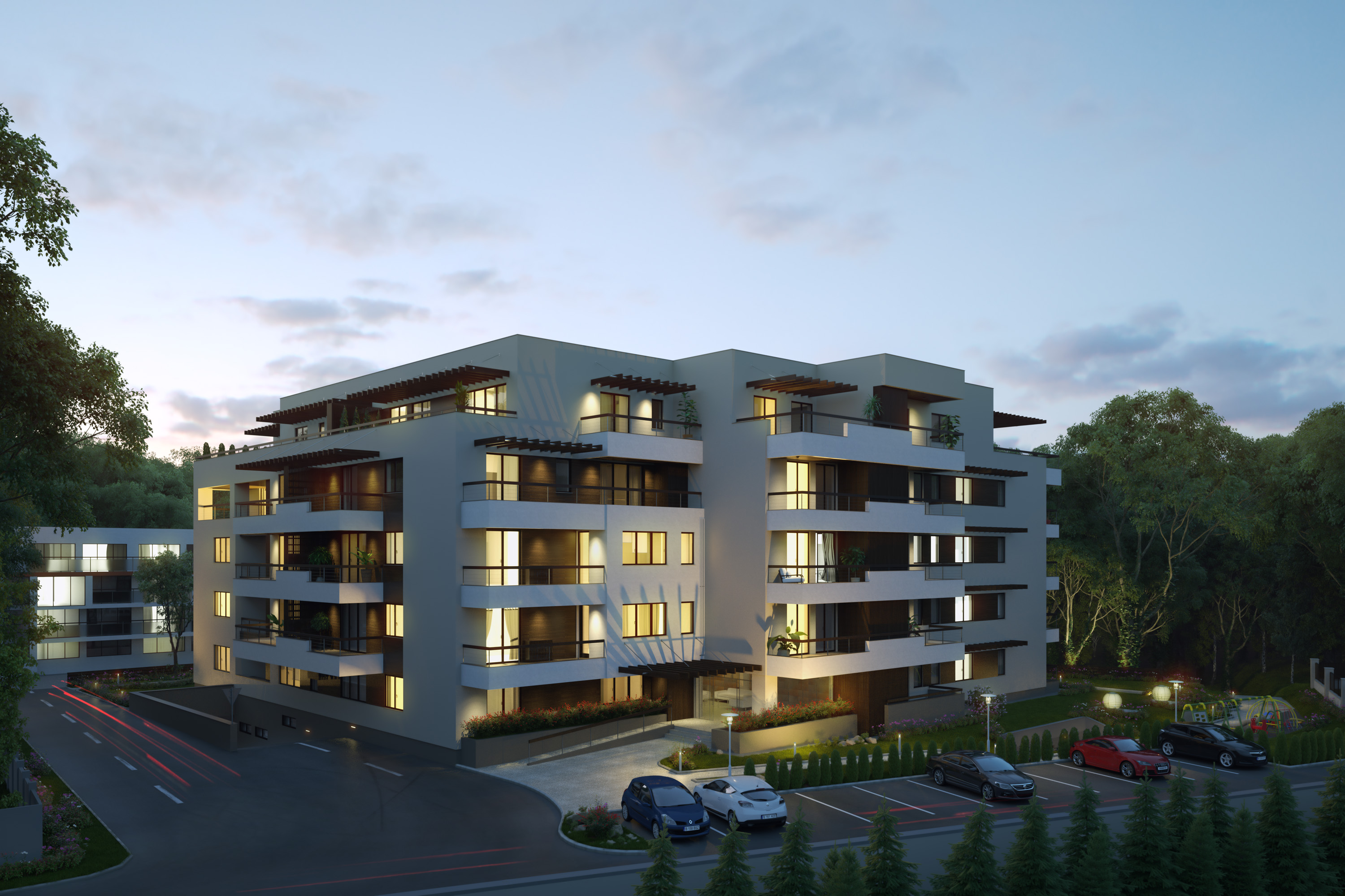

85 % of this scene is using xref files.
All the trees, bushes, grass, cars, lamp posts are Xref Objects.
Also i have almost 100 lights in this scene.
I am using 5.5 Gigs of 5.6 available on my Titans (rendering 6000x4000, i can not render 7000px because is too much for video memory).
I don't know what you call a "real scene" but this is as real as it can get.
Long voxelissation times come from many objects that you are putting in your scene. Render fails maybe because you hit the limit of your video card ?
Try this: Import all your objects in the scene and if it renders fine, than it's an Xref Object problem, if not, than something other is wrong. The idea is to have the same amount of objects but with and without havein them in xref files.

hi lixai, it was too early in the morning (5am) to take care of anybody :-)
You are right, it is a pretty nice scene with a nice mood.
Can you give more info on lightning and rendering setting ? Thanks
lixai
Posts: 172
Joined: Tue Apr 27, 2010 9:32 am
Location: Romania, Bucharest
hi HHbomb,
So, this is the final version of that render, a bit of photoshoping.
Render settings was PCM (about 15 hour render on 2 titans 6000x3000px, hope after giving the scene to Karba, it will help him optimise octane to make it faster), there are lots of lights (104) some are IES, some are plane lights, colors varies from 2800k to 5600k temperature.
Scene was lit with HDR file that you see in the background.
Also rendered a AO version, with all the lights in the scene turned off (only HDR). That render was fine in about 20 minutes.
And the rest is usual architectural post-production.
I left a bit more space in the sky because this will be a 3.2 x 2.4 meters printed panel and there will be some text inserted.
Core i7 860, ZOTAC GTX 580 - 3GB, 2 x GTX TITAN, 32Gb RAM
mbetke
Posts: 1303
Location: Germany
Very good scene. I do a industrial complex at the moment and this is a great insporation of quality to match. :)
One little thing which is distrubing are the red lines without some kind of blured vehicle at the end of it.
PURE3D Visualisierungen
lixai
Posts: 172
mbetke wrote:Very good scene. I do a industrial complex at the moment and this is a great insporation of quality to match. :)
thanks, i know what you mean about the blured vehicle, let's pray for motion blur, and that won't be a problem :D
