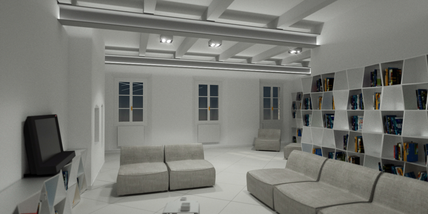

this is my last job I'm doing ...
How could I improve these images, in your opinion?
Have been made with the methods:
for "Pepoli_s1" pathtracing
Pepoli_s2 for "pmc
Both were calculated up to 5000 samples in about 1h.
thank you very much for any comments and suggestions
Pepoli WIP
Slightly overstated aperture
you can add colors and brightness.
Reflections are not very many, you can increase the caustic to 1, it will give an advantage to the hot pixels.
Wood color - not a great success.
You can add colored lights. you used the standard light, try maybe colored spot
