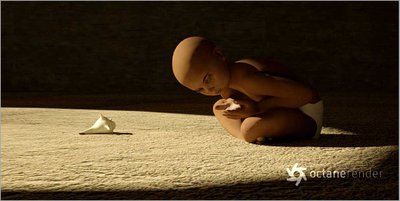

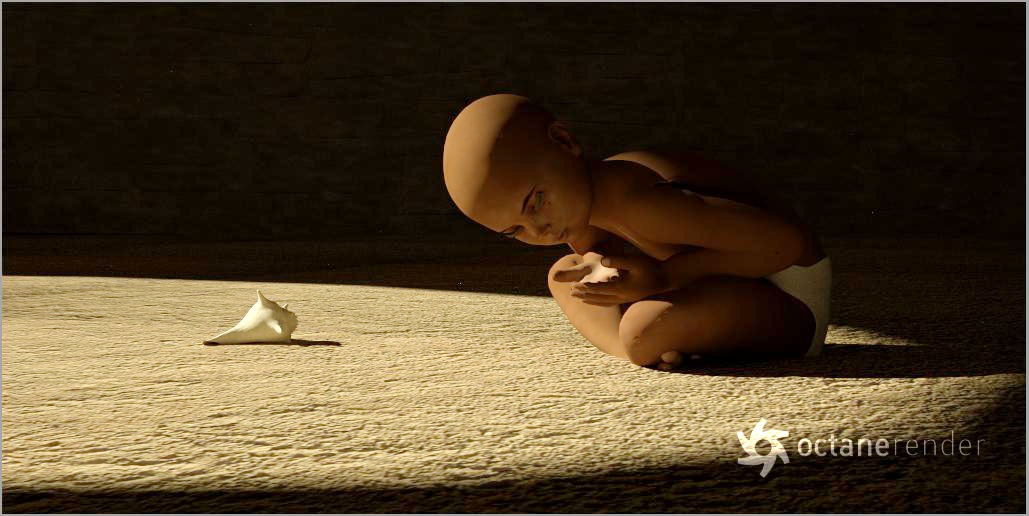

Here is a little experiment, with skin and sunlight.

Still playing with skin textures. Now if I could only figure out the eye surface issue.
