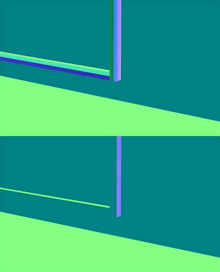

Can you also post the images using the "Shading Normals" mode? These are the ones used to calculate the shading. For objects like this, with hard edges, it should look the same as the geometric normals.

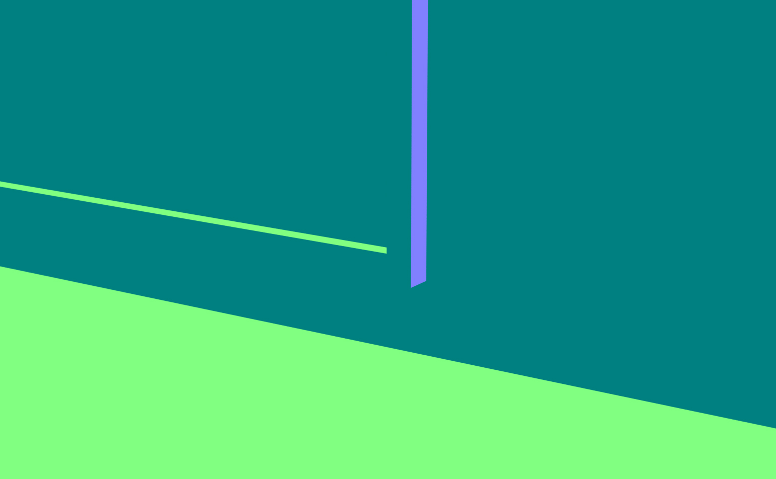

The reason for the difference between 1.16 and 1.17 is that there was a bug fix in 1.17 for reflections which means the mirror frame surface "normals' are interpreted differently. The fix for your scene is to DISABLE SMOOTHING on the frame material (material "sides" and "Top_and_bottom". You really should turn OFF smoothing on all flat surfaces (ie. the walls), particularly if they have a very low polygon count (ie. 1 polygon for an entire wall surface).

@roeland, here are 2 renders, showing the shading normals (1.17).
1st one is with smoothing enabled, 2nd one with smoothing disabled:
