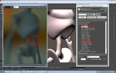

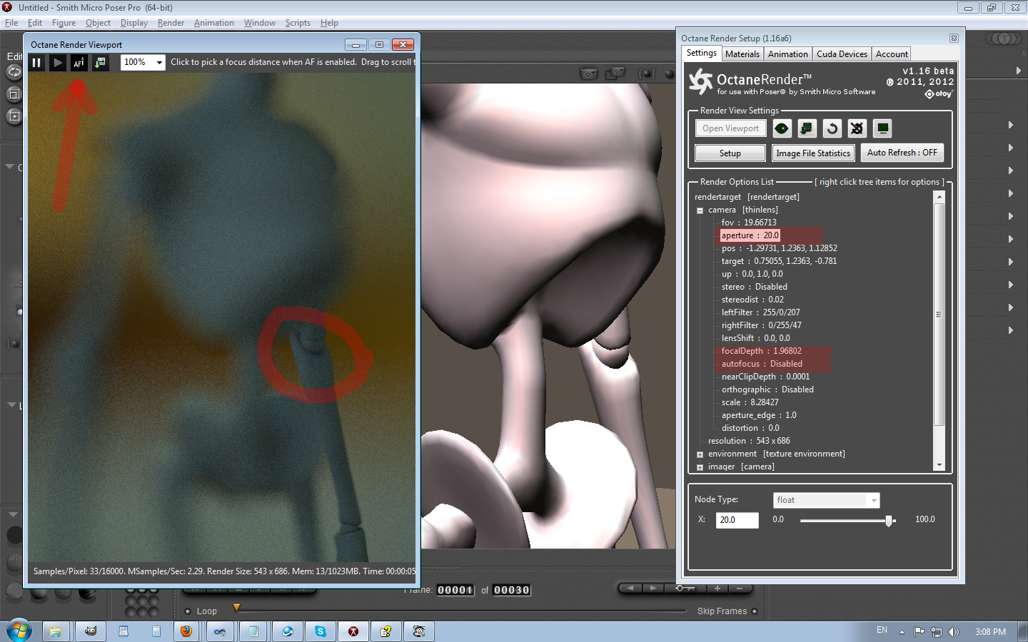

To see "focus picking" in action......
- set the camera aperture to 20 (so everything will be out of focus exact geometry at the very close distances to the focus point)
- Activate the A/F button on the Viewport
- Click on a part of the figure
- Once clicked, the focalDepth will automatically be put in the "camera" pin for "focalDepth", and "autofocus" will be Disabled
If you click on part of the scene where there is no geometry, the focalDepth will not be updated.
Paul
