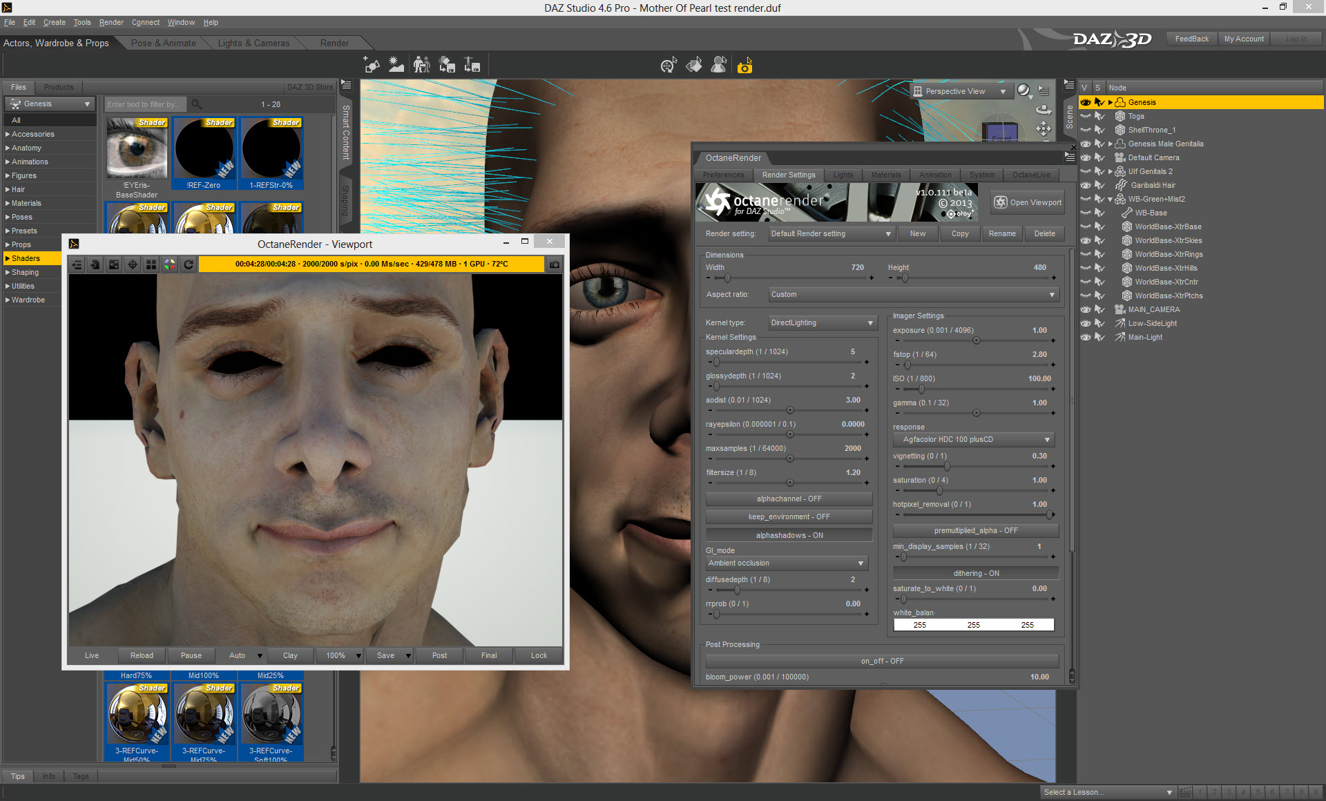

jimgale wrote:This may not apply... but... at least in the Daz plugin, there's the "rayepsilon" which (sometimes) looks like 0.0000 but may be 0.00001. Anything other than zero can cause this. Try setting it to 0.01 then to 0.00 to see if that helps.
I noticed this post when looking for a fix with the black eyes.
I have tried this but it has yet to fix my problem.
Perhaps its is due to using !EYEris-Shaders etc but I'm not sure about trying the methods in the links but i will. Still learning the ins and outs of The Daz Plugin.
Any assistance would be greatly appreciated.

Trying different material turned the skin a different color for some reason.. but alteast that is a different fix give and take.

The odd thing is i got my skin back just by adding the M5 Phillip Material and then undoing because the material could not correspond with the morphs..
IN doing hte eyes come back but are grey perhaps without and skin or shader.
