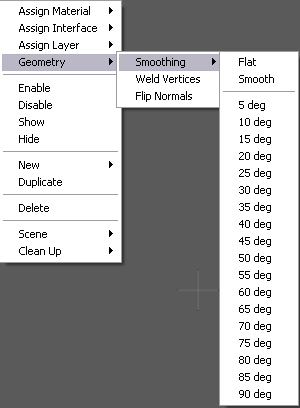

Thea have these smoothing options:
Something similar would be nice to have in Octane aswell ;)
Cheers.
