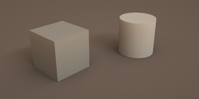

Here are two quick attempts that I made.
In Blender, I didn't do anything to the default cube, but I put it on it's own material so that I could control the "Smooth" parameter of the material independent of the cylinder. For the cylinder, I used smooth shading and then used an EdgeSplit modifier which breaks the cylinder surface into the two caps and the side (while still retaining a single object).
I downloaded Modo and had a try in it. I couldn't find anything similar to an Edgesplit modifier, but Imported the scene into blender and performed the Edgesplit modifier on the cylinder and imported into Octane. I unchecked the "Smooth" parameter on the cube and left it on for the cylinder.
I just need to figure out how to do the similar function as Blender's Edge Split in Modo. But, since Blender is free, you could always just add it to your pipeline.

Modo does in fact have an edge split, its under the Edge tab > Split. IMO it might be useful to have a edge split option for OBJ import, it can split base of boundary of materials, Thea does this - great time saver.PhilBo wrote: I just need to figure out how to do the similar function as Blender's Edge Split in Modo. But, since Blender is free, you could always just add it to your pipeline.
Phil
