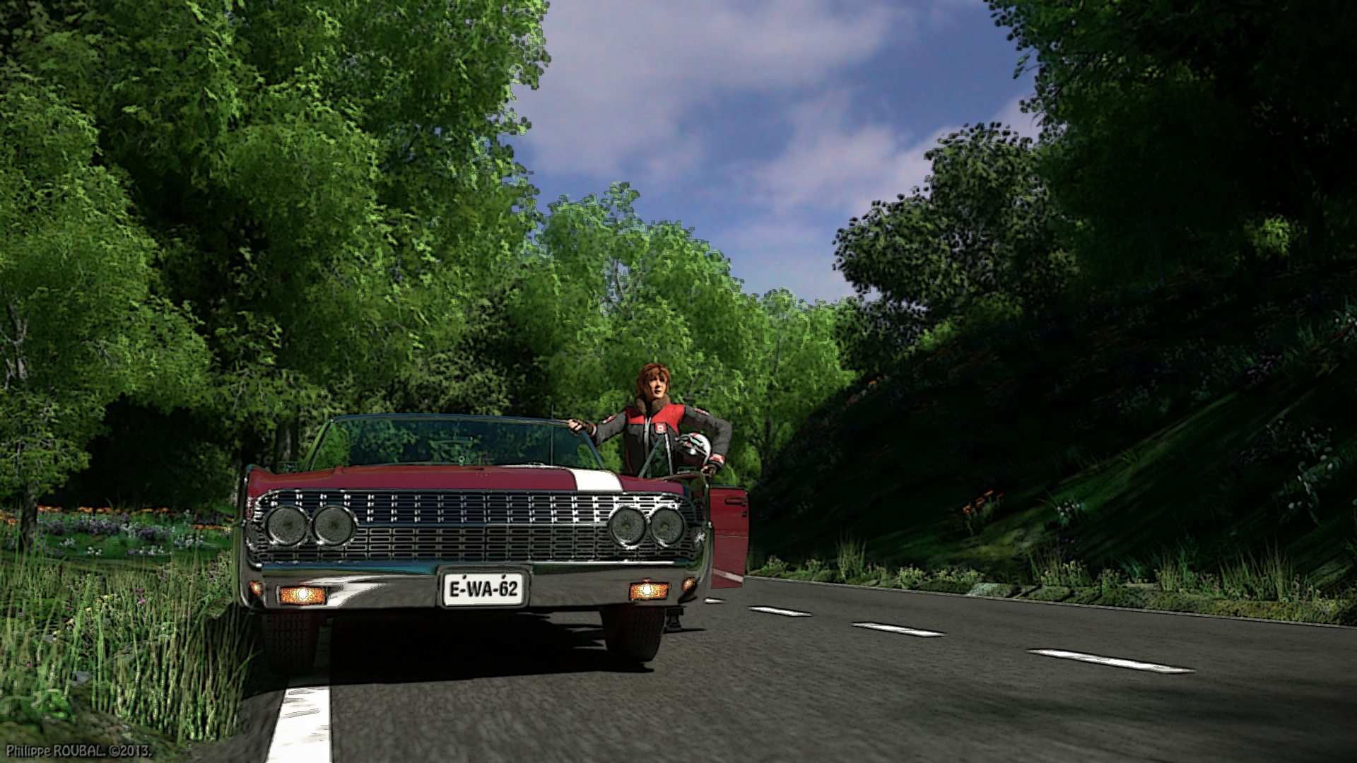

Elisabeth on the side of the road. Little motor problem.

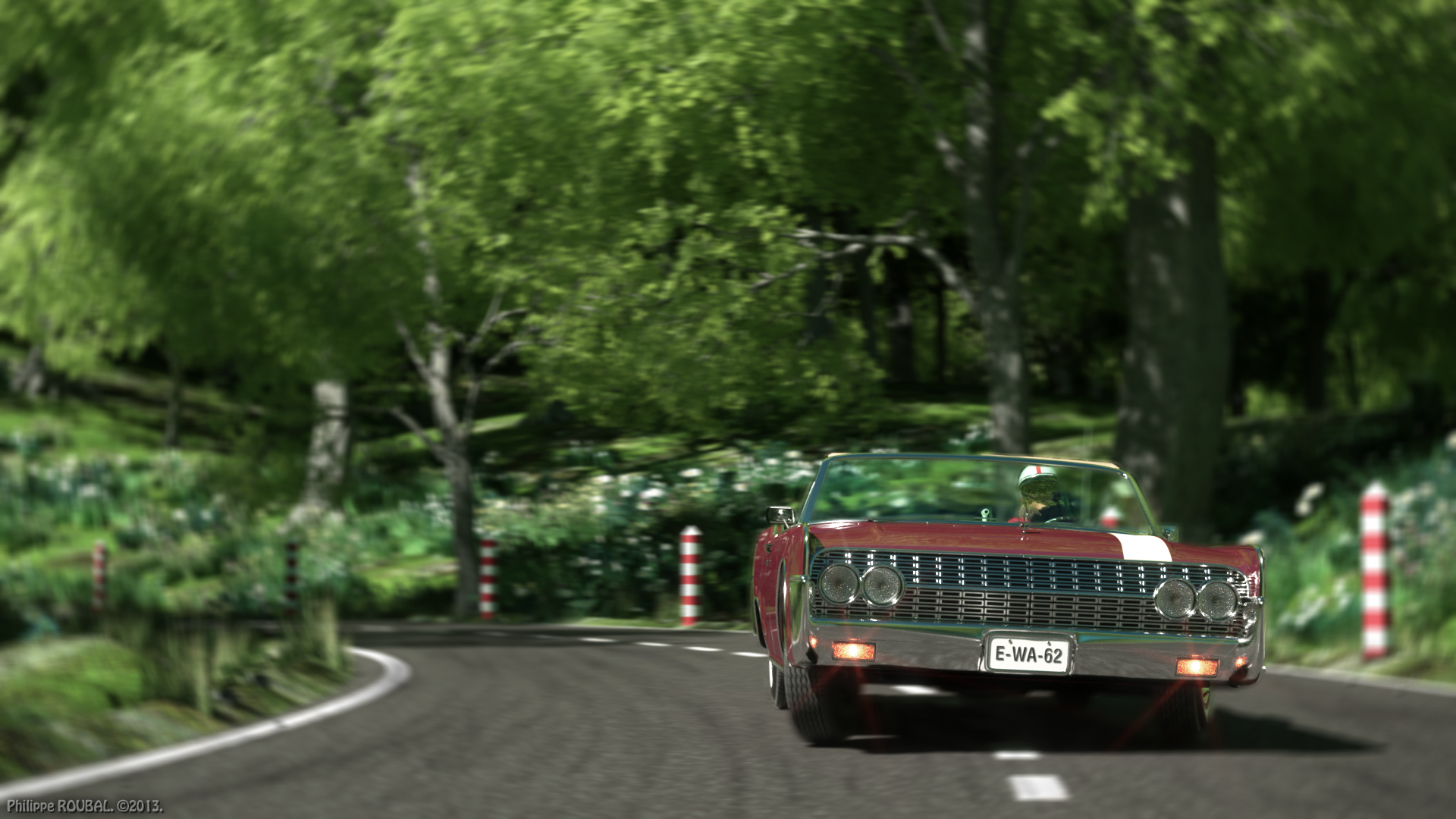

Loosing time...

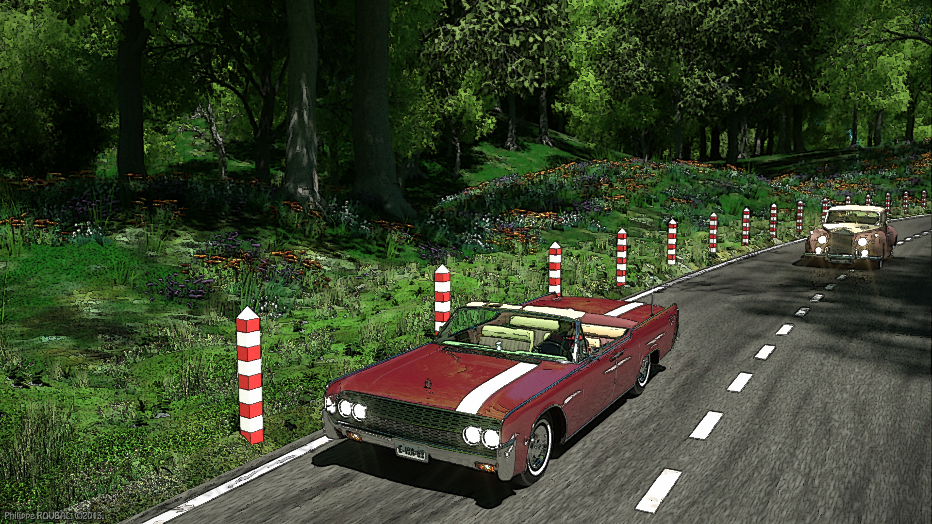

Coming back toward the victory !
