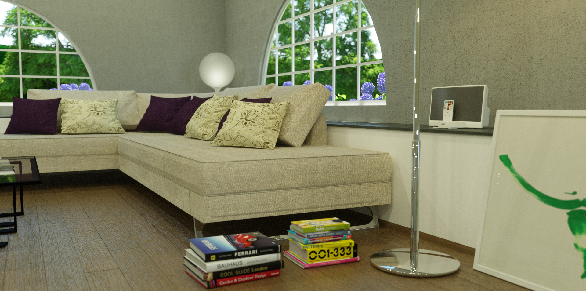

Interior test Octane render for c4d
hi giacomo, well done
there is something strange in the metal of the lamp on the right
it would be nice to see more light coming from the windows, you can boost the environment light or using an invisible emitter instead of the glass
ciao beppe
ciao beppe

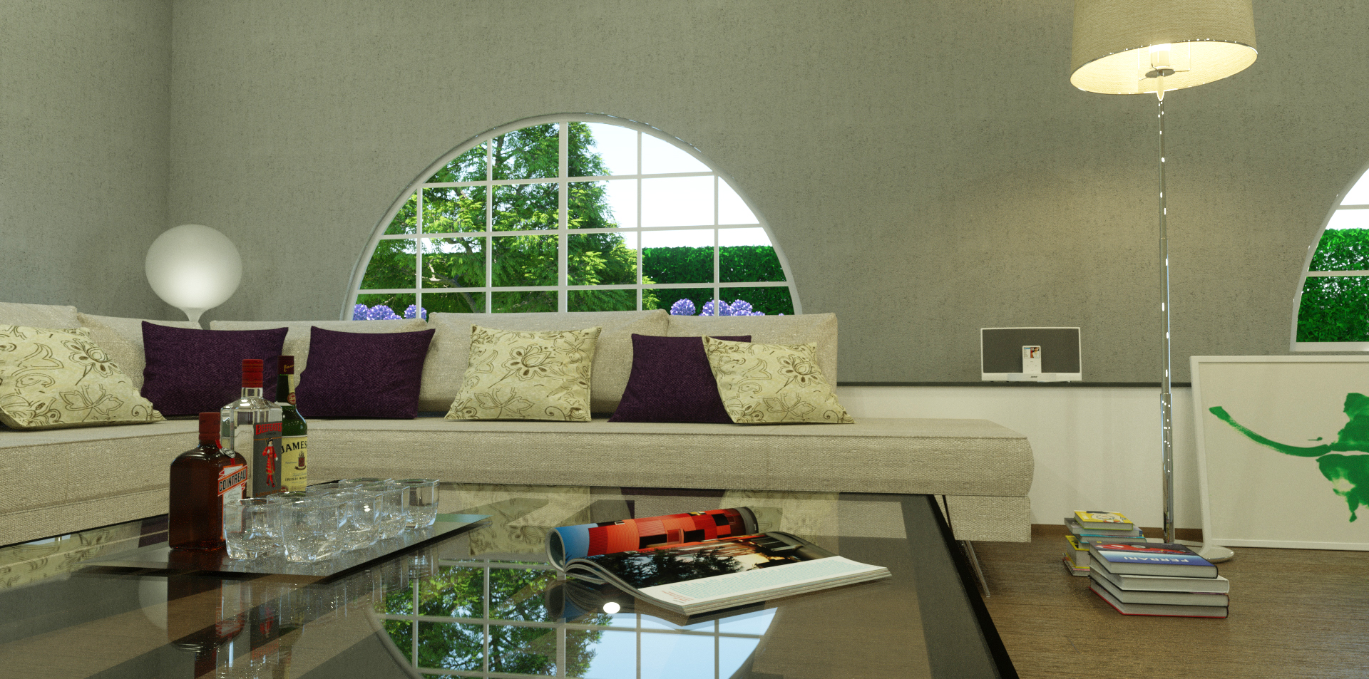

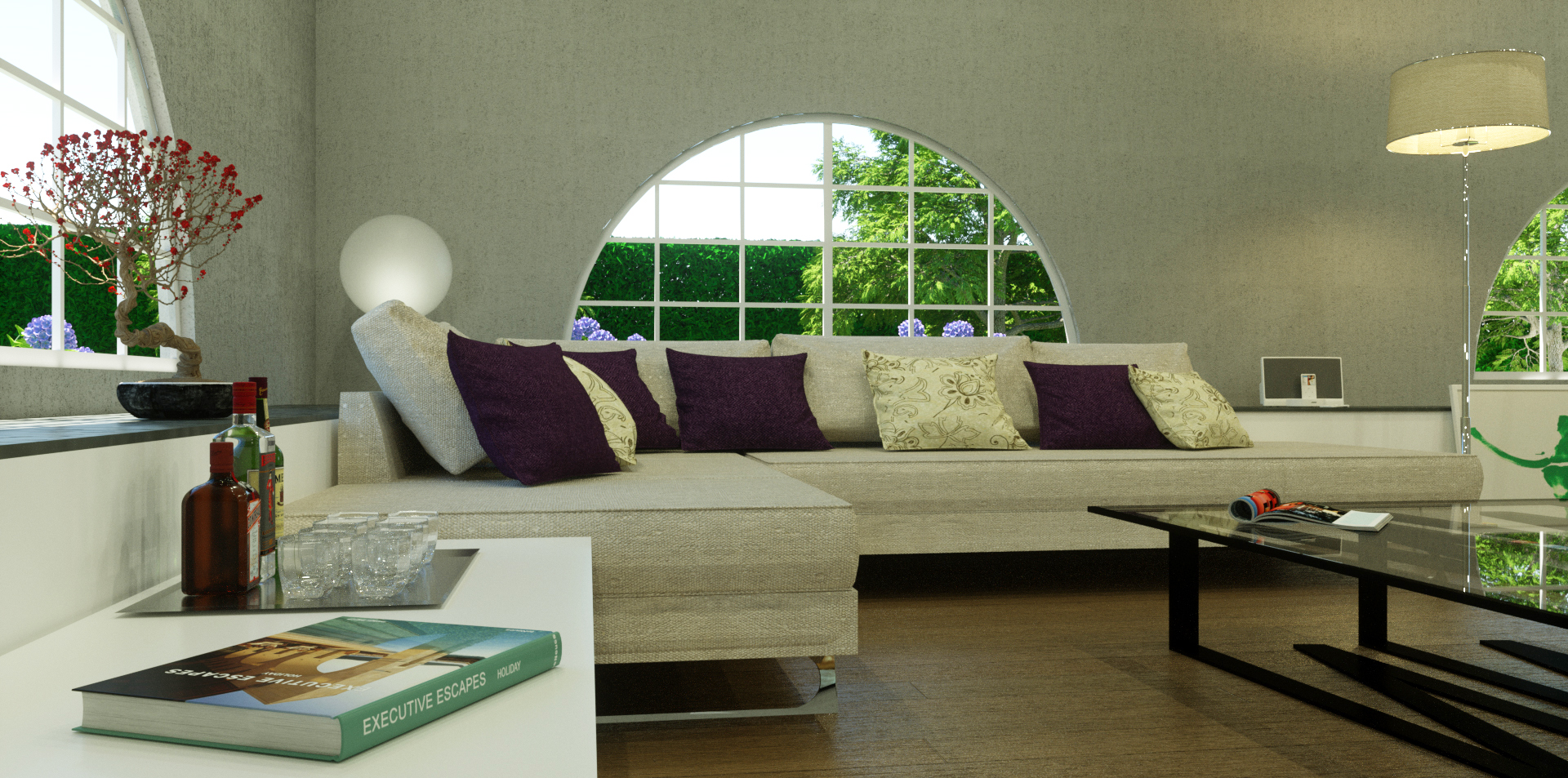

Hi Giacomo,
I think that your colseups are really nice and works almost good:
- the couch and the square cushions should be more detailed and the texture better mapped
- the tray for the glasses and bottles is without shape (seems to be just a flat plane) and seems is floating
As for the wide angle view what "sounds bad" for me is:
- the windows looks little too short/small in proportion with how much space remain to the ceiling, but I'm not an architect so I hope that someone else could give his opinion...maybe a false ceiling is needed (would be cool with a lightened perimeter or hole).
- the walls texture works good only in the closeups (evident tiling in the other shot)
- too much naked walls...It took me different time to realize that the picture on the wall in real was a TV
, you could add a couple of speaker
- the left part of the room is quite totally empty respect to the right (I think that some other object is needed)
That's all. Don't think that I'm too rude with you, it's only the fact that I feel that you are on the right way and with only little adjustments your scene could be lot enhanced

Personally, I don't like the image outside the window.
i would change the saturation and levels so it doesn't distract from the interior as much as it does. A common thing I do is take the mid level and move it towards the white. This can give you a much brighter image that still retains detail but wont be so distracting. Also, do a slight blur filter on it.
Things that are high saturation and contrast will draw the eye. You want the outside to create ambiance, not distract the eye.
