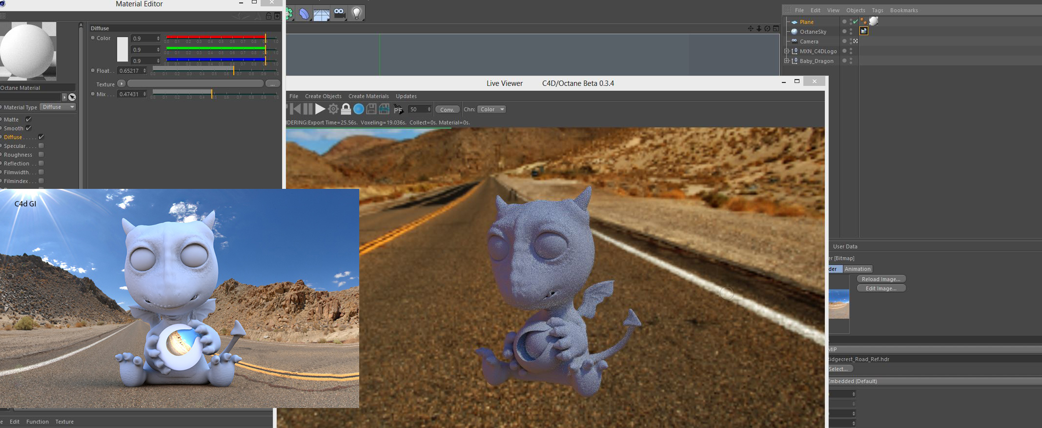

in vray, I use vray compositing tag, in c4d, I use built in comp tag, usually, when I want to hide something or if I want to integrate,
I tried to apply the c4d compositing tag in octane, but is not working. Is this a future dev?
I`m trying to apply a ground plane over an HDRI, so I can get some shadows, like so, first 15 seconds:http://www.youtube.com/watch?v=huuF0WLE1f4
Thanks!
Posts: 10618
octane works in a different way so you can't expect exactly the same functionality of the compositing tag.
anyway, if i have understood correctly your needs, you can assign to the plane an octane diffuse material and activate the matte option in the basic tab in the attribute editor, play with the diffuse colour and opacity and that's it ;)

after messing with it for a couple of hours, couldn't make it to work
In the attached you can see that the material has matte and diffuse enabled, and tweaked every setting in the diffuse channel, with no luck.
On the left is a quick HDRI setup in c4d Gi, which shows how the ground plane is catching the AO/shadows from the model.

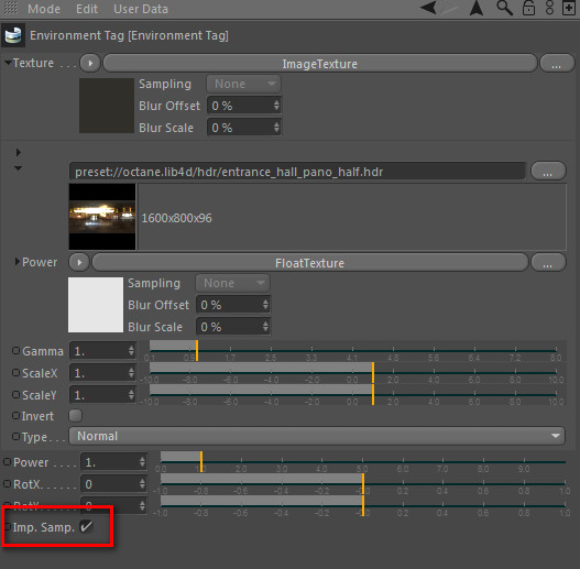

I suppose you need to activate importance sampling option. And disable keep environment

....and where do I find the click for " keep environment". Looked for it all over the place
thx
Posts: 16068
Location: Türkiye
stoiqa wrote:....and where do I find the click for " keep environment". Looked for it all over the place
thx
in settings->kernel
