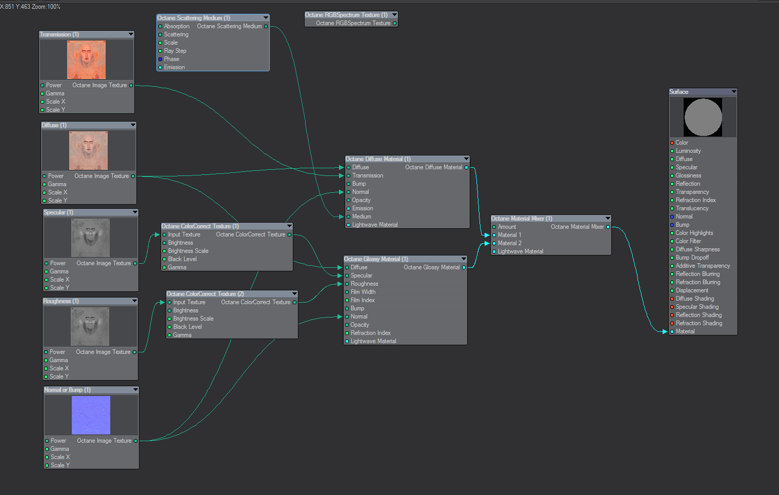

No worries. Here it is. As I said, it is just adapted from the one on the link on the first page - very helpful info.
what I need to understand more is how the absorbtion and scattering inputs can be used, what they do, and if a map would be more helpful. It seems difficult to get a good 'glow' through the ear, without the light going right through the head. Perhaps having a low res internal model would help.

This may be more helpful as I realised how to get the maps to show in the nodes :)

Thanks for the pics; they will be more than helpful!
