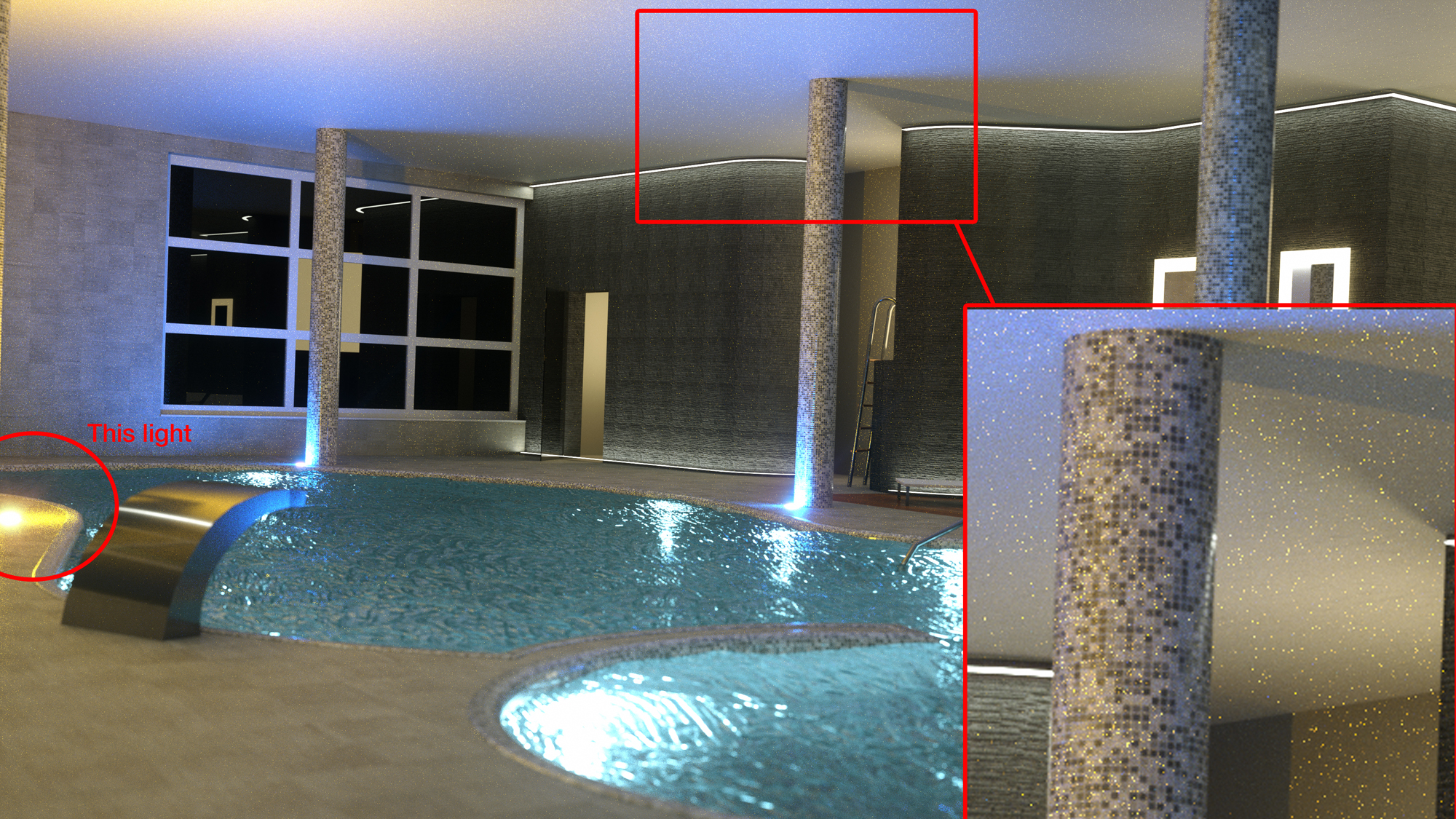

Hi there. im working on interior viz with octane. This is for me first scene with it. Right now i have problem with noise from light. in the attachment a show light source, which produce a lot noise and flicker points. every other light source are good, even it is the same material.... Light source: plane 50x50mm, about 10mm above ground plane. material blackbody with RGB color, 25 multiply. octane 1.10. thanks for answer

the light is too much small
try to use pmc kernel or pt with caustic blur set to 0,5 or 1
and hot pixel remove to 0,75 or 0,5
the fireflies comes from the pool, turn off sequentially all the lights to see what happens.
