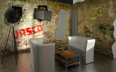

I have problem when changing resolution, i can made it only once, then when i pause render, change resolution second time and resume render, nothing happens. I must click "restart render" button to apply changes.
If i change the type of environment, from daylight to texture, i also must click "restart render"
I can change sun and sky colour, but not ground plane colour :cry:
I didn't encounter a problem with transparent bitmap shadow, mentioned by ROUBAL.
One more big problem. See atached image. Directlighting preset 3, glossydepth 5, "alphachannel" and "keep_ebviroment" on. Odd transparency bug.
