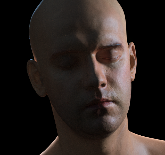

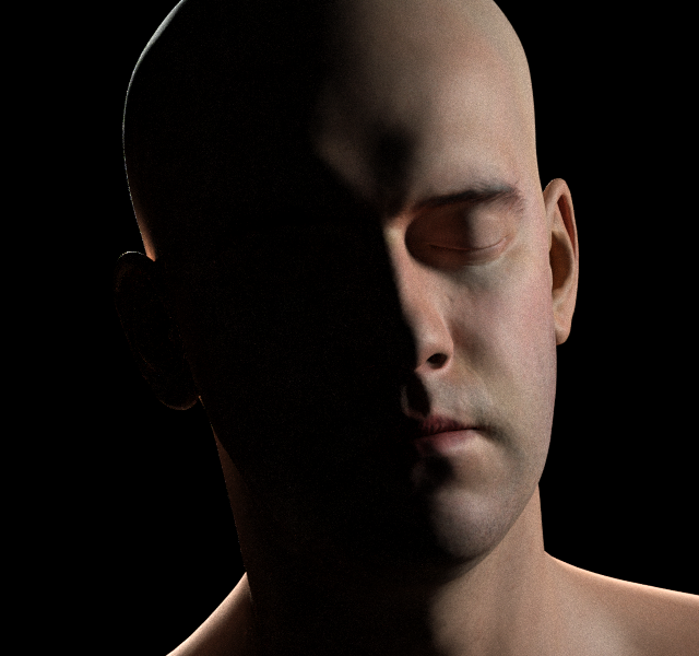

Postby face_off » Thu Apr 04, 2013 11:51 pm
face_off Thu Apr 04, 2013 11:51 pm
mib - I have downloaded that head model - and it is fantastic! The normal maps make all the difference. Is this model/maps publicly available - or are you providing it just for getting the SSS shader together?
I need to let this run for a bit longer (7mins on my low-spec card is not enough). I'm getting some glossy reflections of his eyebrows - which I need to kill.
EDIT: That's without the SSS map.

Re: Skin shader with SSS
Postby face_off » Fri Apr 05, 2013 3:58 am
face_off Fri Apr 05, 2013 3:58 am
9000 samples version...
I think the glossy is too much - and that is a function of some glossy creeping through the diffuse material. Next time I would increase the roughness to 0.5 and reduce the specular 25%. I wonder too if maxdepth 12 is too much - since his ears look poor.
