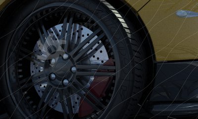

We've been testing octane for quite some time now, and we can't seem to make the bump look correctly.

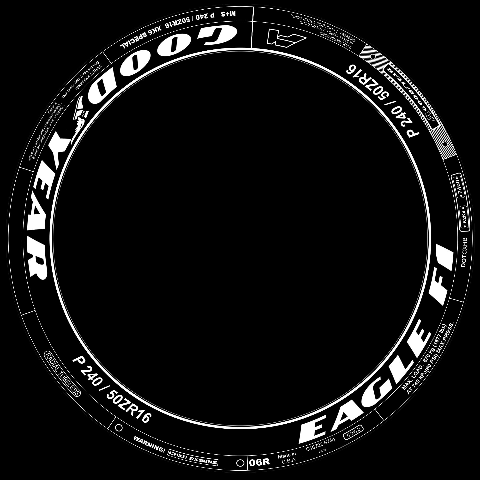

This is the bump map
The first image was used as a normal bump.

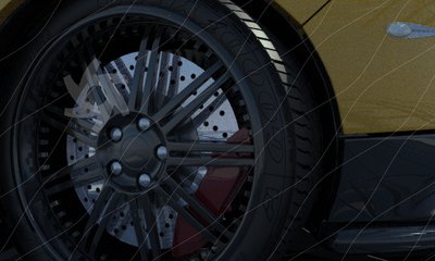

The second image is the same but inverted.
We're getting the same result for both of them and that's not the result we are looking for.

Make sure the you use this image as bump map and not as normal map. And since the bump map has a lot of contrast you need to lower the power of the bump map.

A bump map has effect in areas where the brightness of the image changes. If you slightly blur the bump map, there is a small gradient from black to white, and it will be easier to make it more visible.
