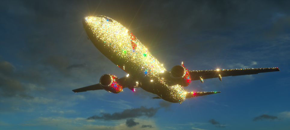

I still have one small problem. I wanted to take a picture of the plane, but I took a picture of a Christmas tree :D

look at the post-processing tab in the octane setting, probably there are some higher values by default ;)
as an hint, you could set all the octane settings as you like in an empty scene and save it as new.c4d in order to get your prefered setting in all the new scenes ;)

In the standalone version of this can be resolved so that it is sufficient to move the Gamma slider in the environment(HDRi) and hotpixels disappear. You can also return the slider to its original value and is still without hotpixels (until you change the texture on model???). In the version of C4D so it does not work. it's "funny" :)
(sorry for my bad english)
Edit.: It's cool. Just set Gamma to 1 and tick Ipm.Samp ;)
