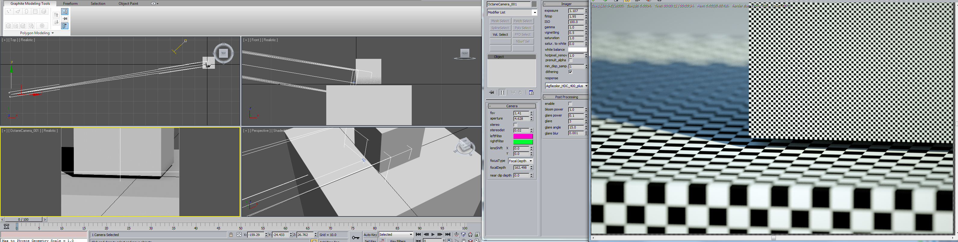

Wow, I think I got it, or the concept at least.
The small box is 3 inches. The big box is 8 inches.
The camera is about 13 feet away from the focus point.
The hardest part was setting the focal depth. Seeing as how I was in US Standard feet w/ inches units setup, it was very hard to get the focal depth just right until I switched back to generic units. Than I played around with the aperture and there you have it.
I appreciate you putting me on the right track glimpse.
