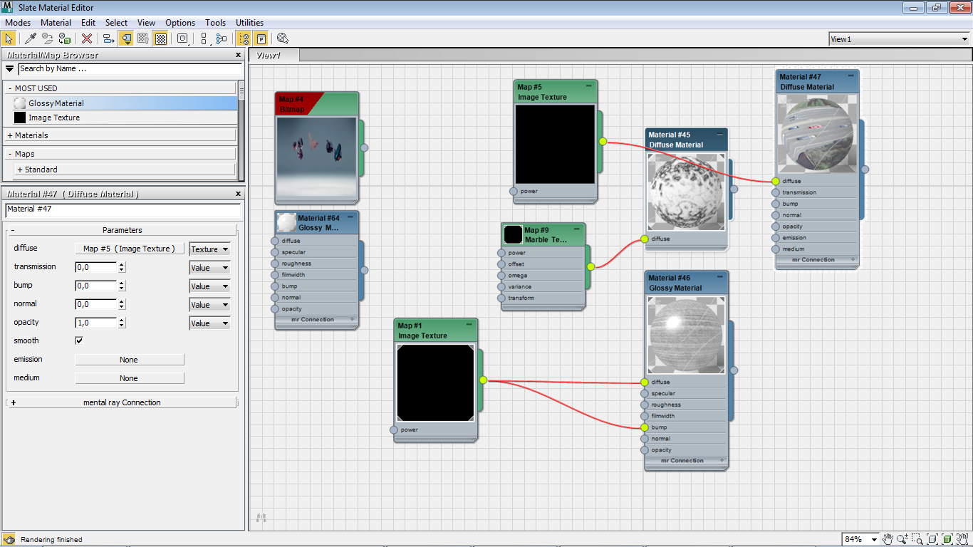

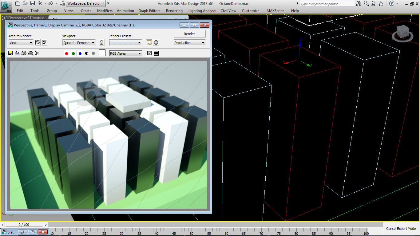

Let me explain, objects appear Dark in my viewport when I use Octane, I can give them back color when changing the viewport setting from realistic to shaded, but when in that configuration I still don't get no preview of the maps and textures used, wich is quite annoying for adjustments and scale setup ... Am I doing something wrong or missing a setting ... ?
Also in viewport, material preview is working but maps appear dark ... Does anyone has / had the same problem ? can it be fixed ?

Use default lighting in 3dsmax viewport settings.retmia wrote:Hello,

Well, I just noticed that they had to manually be activated via material editor not on the material but on the map itself !
Now things are working fine!
Thank You! And thanks for the big work !
