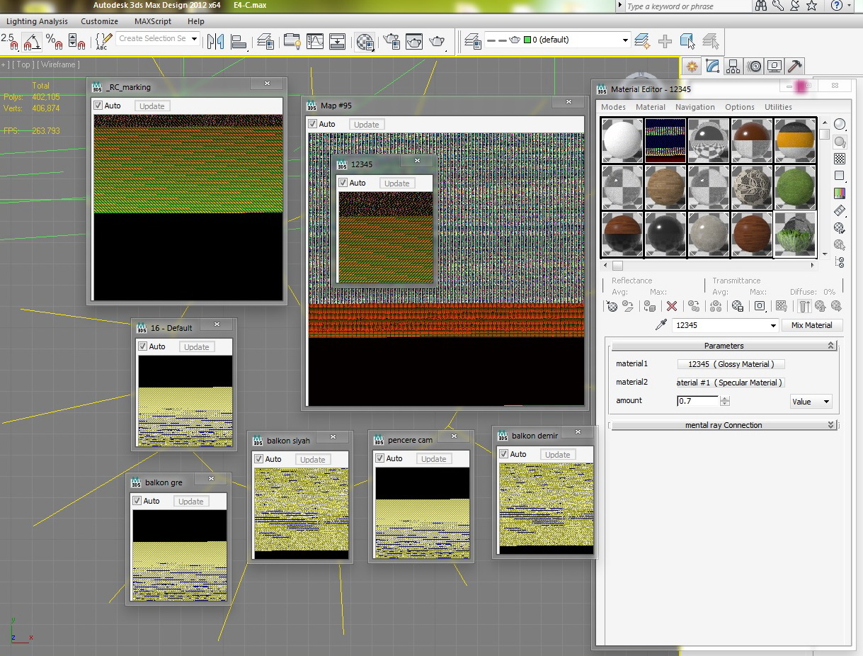

Karba wrote:
Vanya wrote:
Vanya wrote:First opened not very happy :(
Yes please!!! as soon as I start to use Dirt map :?
Could you check for licence activation?
checked..
I do render without problems.
but when I turn to Dirt texture, it happens... and ''max crash''
Core i5 76o @ 2.8o GHz | ZOTAC gtx58o AMP 1536Mb | MSI gtx46o 1o24Mb | Corsair ForceGT SSD12o | Gskill 16Gb RAM 16ooMHz
