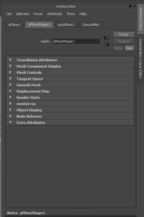

I can't seem to find where this option is on any of my geometry shapes. I can find nothing under extra attributes. Do I have to add a node to the geo for this. Can someone please explain where to find.
TBFX wrote:
Octane: Geometry type attribute (under extra attributes on the shape node of the geo) of your base mesh to either Scatter or Movable proxy.
T.
I cannot find it where that post had described. Is this feature still in v1.02b? Do I have to add a shape node to the Mesh? If I duplicate a mesh with instance turned on, does it automatically create a instance in the Octane Plugin?

It must be there, in the shape tab (exactly where you're looking). Are you sure you are using octane for maya ver 1.02b AND the latest octane native engine (octane standalone)? If so, then you should try to make a clean re-install of octane I guess...

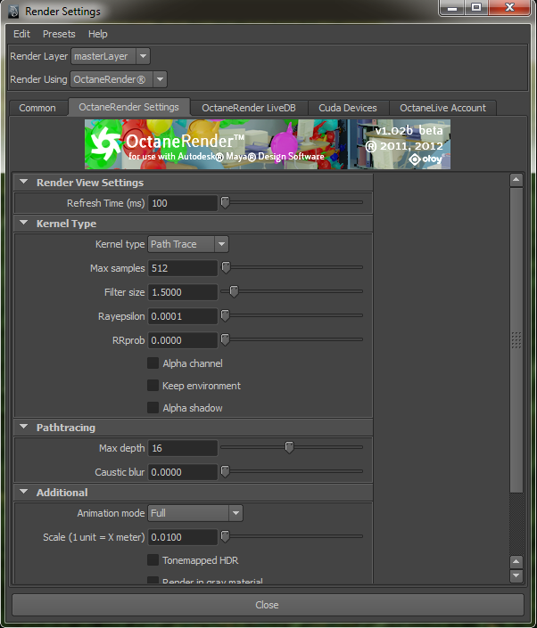

I've posted screencaps of my Octane Plugin which is v1.02b and my Standalone v1.0
If I had to do a clean re-instal. Do I have to un-license my versions, delete them, and then re-install them? Or would deleting them leave my licenses intact?
PhillieDFilms
Posts: 27
Joined: Sat Jul 30, 2011 2:45 am
Okay, so after the painstaking process of uninstalling Octane Maya Plugin, Octane Standalone, and Maya. Reinstalling Maya 2011 SP1, as well as Octane Standalone v1.0, and Octane Maya Plugin v1.02b. The problem still persists. I cannot find the Octane: Geometry type attribute anywhere. Can someone please help me with this issue?

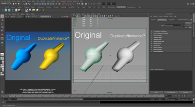

What I'm wondering is. Is octane recognizing my instances and loading them into the GPU accordingly? Or Is it just loading extra copies of my object therefore putting more load on the GPU than is necessary?
Here is a screencap of a test I did using a simple instanced object through the duplicate with special tab. It looks and acts like and instance, yet I can't be sure because I don't know if my Plugin is working properly due to errors like the Octane: Geometry type attribute not being visible. Please respond.
Octane Instance?
Octane Instance?
