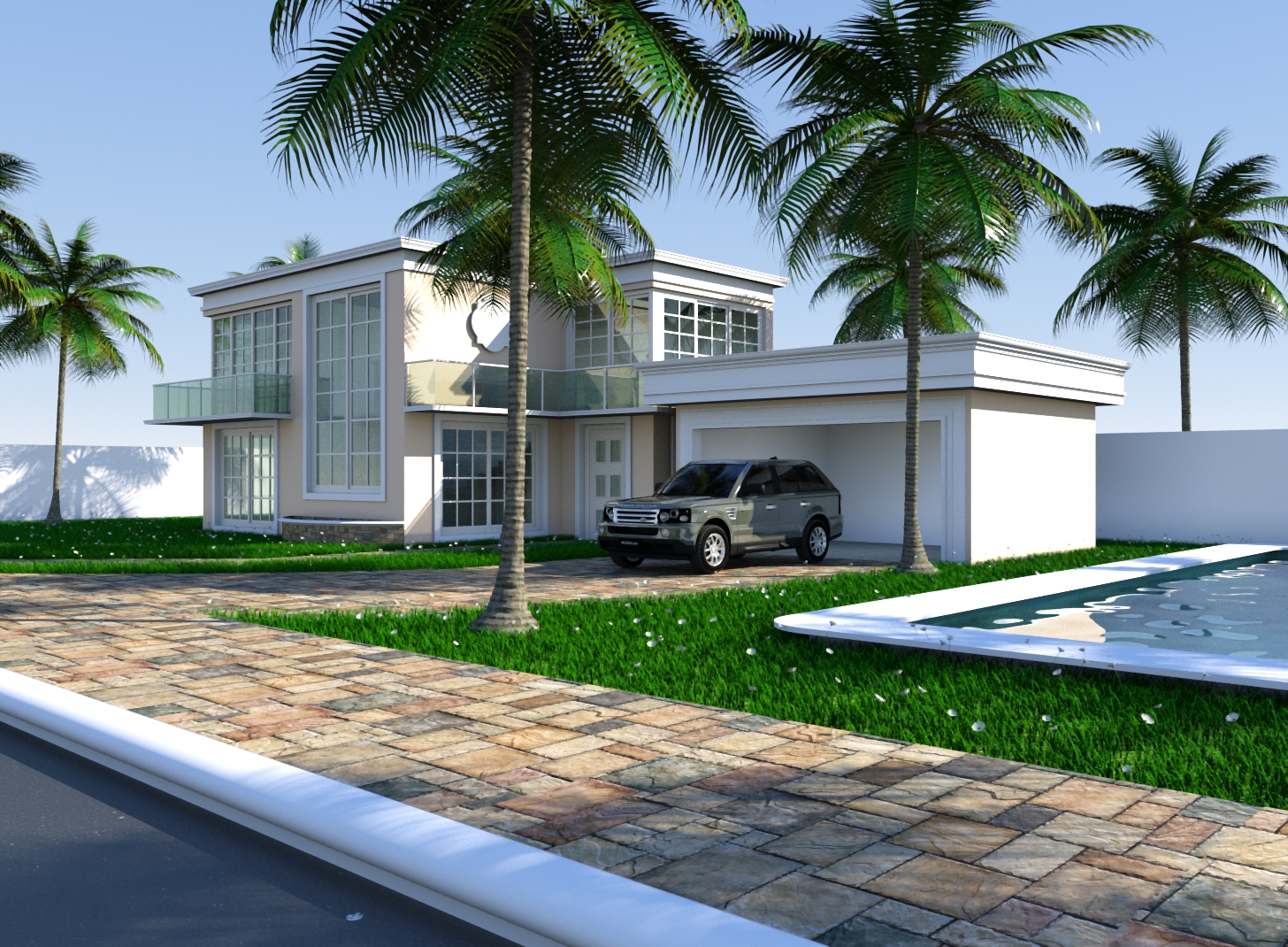

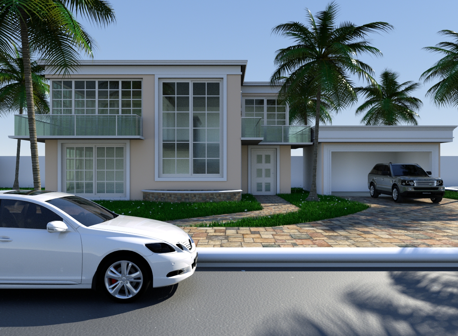

add images, using forest pro 4, still in process render
regards
							first exterior

not bad at all merid,
some material needs to be revisited but for me the most is done

hi paolo, thank you, i don't understand, some material needs to be revisited  ?
can you explain me ? i'm follow the tip of enrico cerica, not creat new material, just convert the original format to octanerender scene if you can comment more, my appreciation to your words.
regards !!
regards !!

I don't know the tip which you are referring.
I think that the glass shader of the cars should be little more transparent, and what about the glass of the front lights?; I'd use a concrete texture for the the border of the sidewalk instead of an RGB value
..this is more or less all
