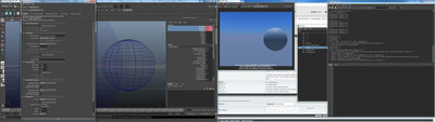

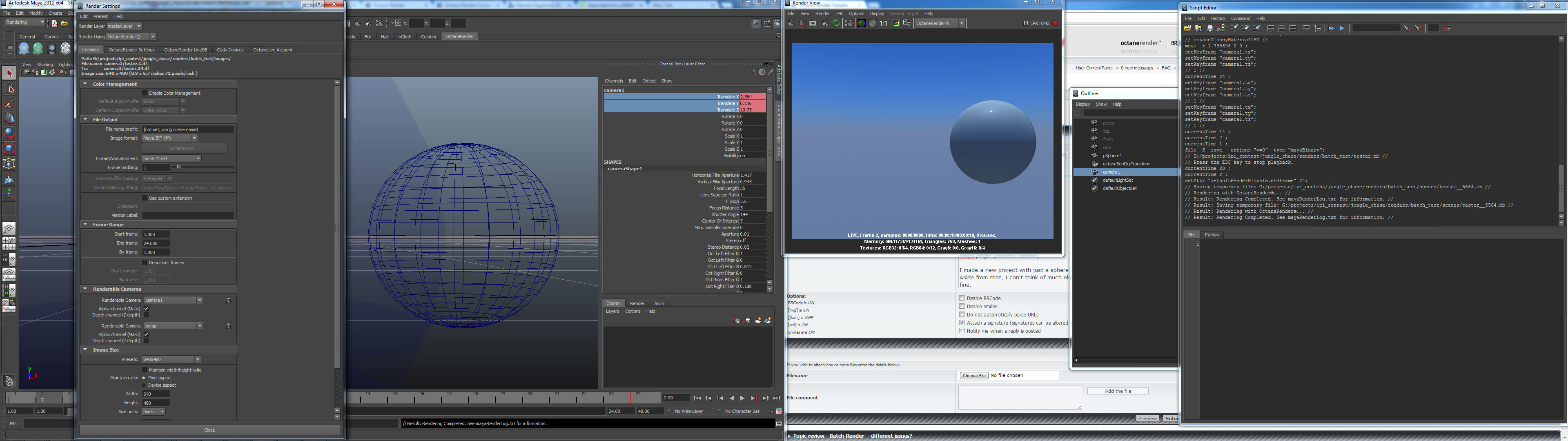

I made a new project with just a sphere with a octane material, an animated octane camera, and an octane daylight setup. camera keyframed over 24 frames, set to output an image sequence.
Aside from that, I can't think of much else to report...the project is pretty much as basic as it can get, I think. Set my project & made the default folders, so everything should be in place. IPR works fine.
Main drive is an SSD (just OS and minor stuff)
maya is on D: separate disk
I'll attach a screenshot, but it's stuff I think you've already seen before.
Any chance I can at least get some older working beta versions? Would be wonderful to be able to batch...I'm falling quite behind on some of these animations.
Thank you!
