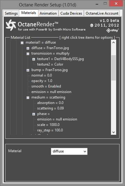

Here's what I've got until now:
Yes, the transmission is crucial, and I found, I even need a SSS map because not all areas of the skin have the same transmission (lips, ears - more, legs, arms - less, you get the picture). I multiplied the map with a pale red. You might get away with a transmission color only, but that might increase the 'waxy' feeling because of the more equal distribution.
Based on this I came to the medium settings of
absorption:0, scattering:0.09, direction:0.8 and scale:1000
which would mean a scattering depth of 9 mm, what seems quite reasonable to me.
Direction goes more to +1 because we want the light to travel through and not reflected.
I didn't use absorption at all, because it only decreases the effect.
I guess, the scattering value and the transmission color can be tweaked a little more, but I'd say, it's a good start.
Tell me what you think.
Regards, Uwe

Interesting Uwe. And yes, a very good start. I assume you've seen http://poserphysics.blogspot.com/2012/1 ... hader.html?
I only did studies with frontal and side lights - not back lights. In those cases, I didn't find any difference between -1, 0 and 1 for direction. However the reflected light should be as important as the backlight - so I thought 0 would be the best for the direction.
I found with absorption at 0, there can be a buildup of light inside the mesh - which is what is happening in her nose. Again, I'm not expert, but I found you need the absorption near the scatter value so that the light doesn't scatter forever.
Yes, transmission is vital. Either pure red, or the diffuse texturemap. I havn't used an SSS map yet - but yes, I think it's needed. I had a lot of trouble where the correct SSS settings for V4's face make her hands glow bright red if there was a side light :-)
