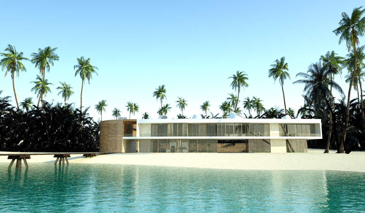

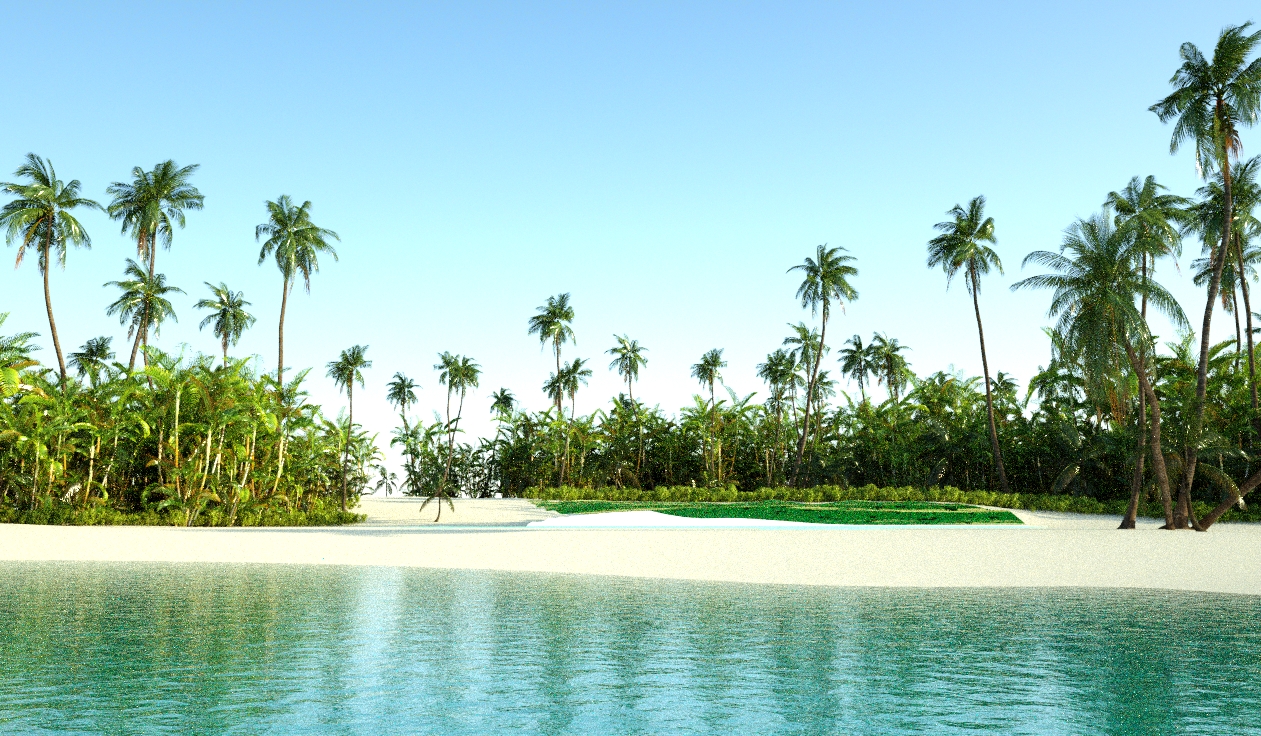

There are two renders, that shows my problem. Sometimes, when in scene too much objects, textures from some objects are dissapear and its renders in black color.
On my renders you can see it - when I open layer with the house, foliage gets black. But without house all is OK.

You should reduce image textures amount. You can use only 64 image textures for GTX5xx and 128 for GTX6xx

OK. Thanks you for information. :(
