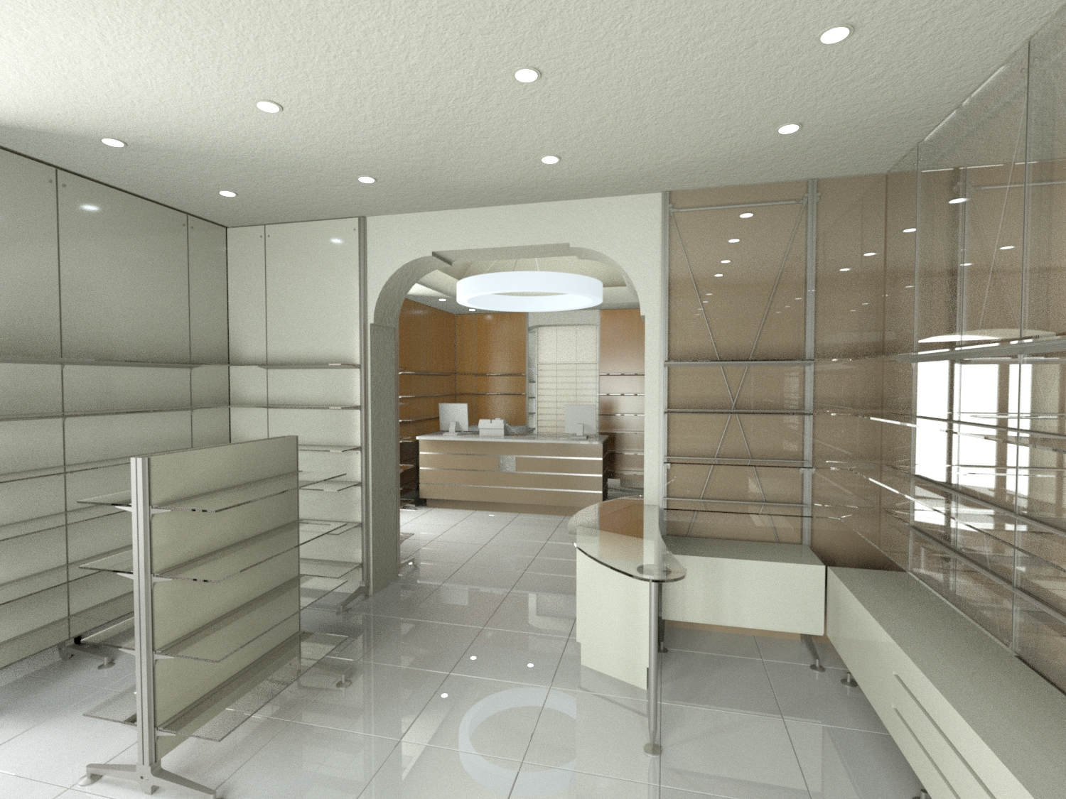

there must be a problem with my AO settings
I cannot avoid too dark "shadows" in the corners, even when I lower the "AO distance" (at too low values all colors looses their hue)
Hope that someone's suggest could be helpful
Cheers, Paolo
Cheers, Paolo

could you send a render?paoloverona wrote:there must be a problem with my AO settings![]()
Hope that someone's suggest could be helpful![]()
Cheers, Paolo

Hi wisemanxxx, sorry for the delay.wisemanxxx wrote:could you send a render?paoloverona wrote:there must be a problem with my AO settings![]()
Cheers, Paolo
I was made a test for post my "bugs" (I didn't save none of my old tests) but now, with the new realease of Octane for Max the DLin AO mode seems to work.
Before this new test by changing the "AO distance" the render became out from totally washed out to a middle gray, now at high value of "distance" the scene become totally black.
I've posted a test...ok, now I can start to tweaking with AO+Fake Sun
Thanks a lot wisemanxxx, I'm sure that I'll need soon your help!
Cheers, paolo
intel i7 3820 3.6GHz, 16Gb 1600Hz, windows 7 professional 64bit, gtx 580 3Gb x2, Octane 3dsMax 2.58

A disk ought to be enough. Quite a good renderwisemanxxx wrote:Directlight / AO
render time 12 min. 1xgtx680 4gb
I used a mesh light outside window. 5 cm radius sphere with blackbody emission for simulating sun.
Environment is 255 255 255 white color only.
AO distance is 3

Good render Paolo.paoloverona wrote:Hi wisemanxxx, sorry for the delay.wisemanxxx wrote:could you send a render?paoloverona wrote:there must be a problem with my AO settings![]()
Cheers, Paolo
I've posted a test...ok, now I can start to tweaking with AO+Fake Sun![]()
Thanks a lot wisemanxxx, I'm sure that I'll need soon your help!![]()
