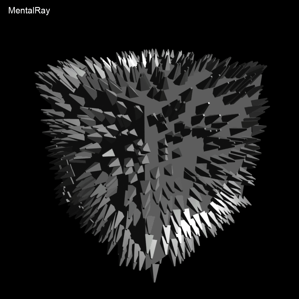

Wrong orintation on ICE particle instance
Autodesk Softimage XSI (Developed by Face)
face
Posts: 3204
Location: Germany
Have spend some time and find an error in the 2011 SDK.
To set a quaternion, the SDK write, set it with quat.set(doubleW, doubleX, doubleY, doubleZ). But it must set with quat.set(doubleX, doubleY, doubleZ, doubleW).
In the 2013 SDK the issues is solved, maybe in the 2012SDK also.
Hope it works now...

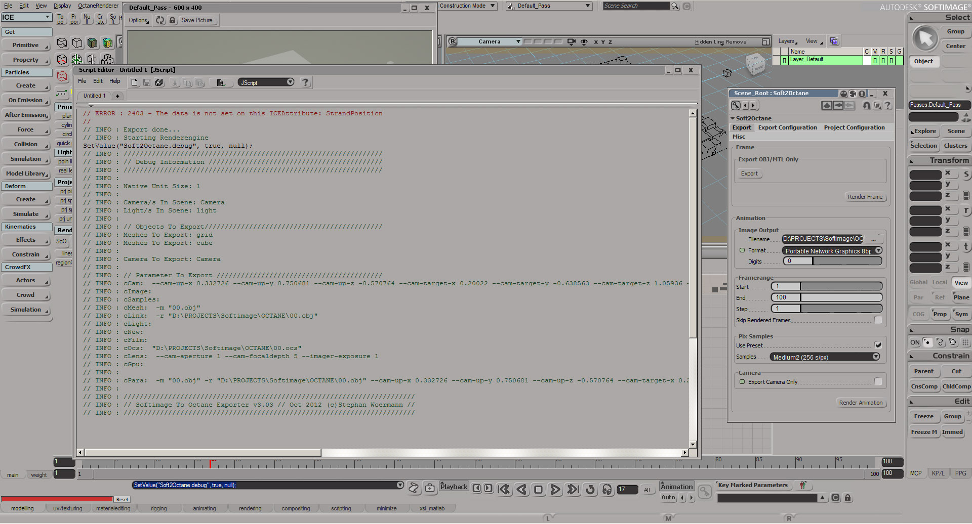

Instances not render, please help. Softimage 2014.
And Soft2Octane error, open Octane without instances. Put log image + debug log.
But export files are created, manually created scene has wrong instances position.

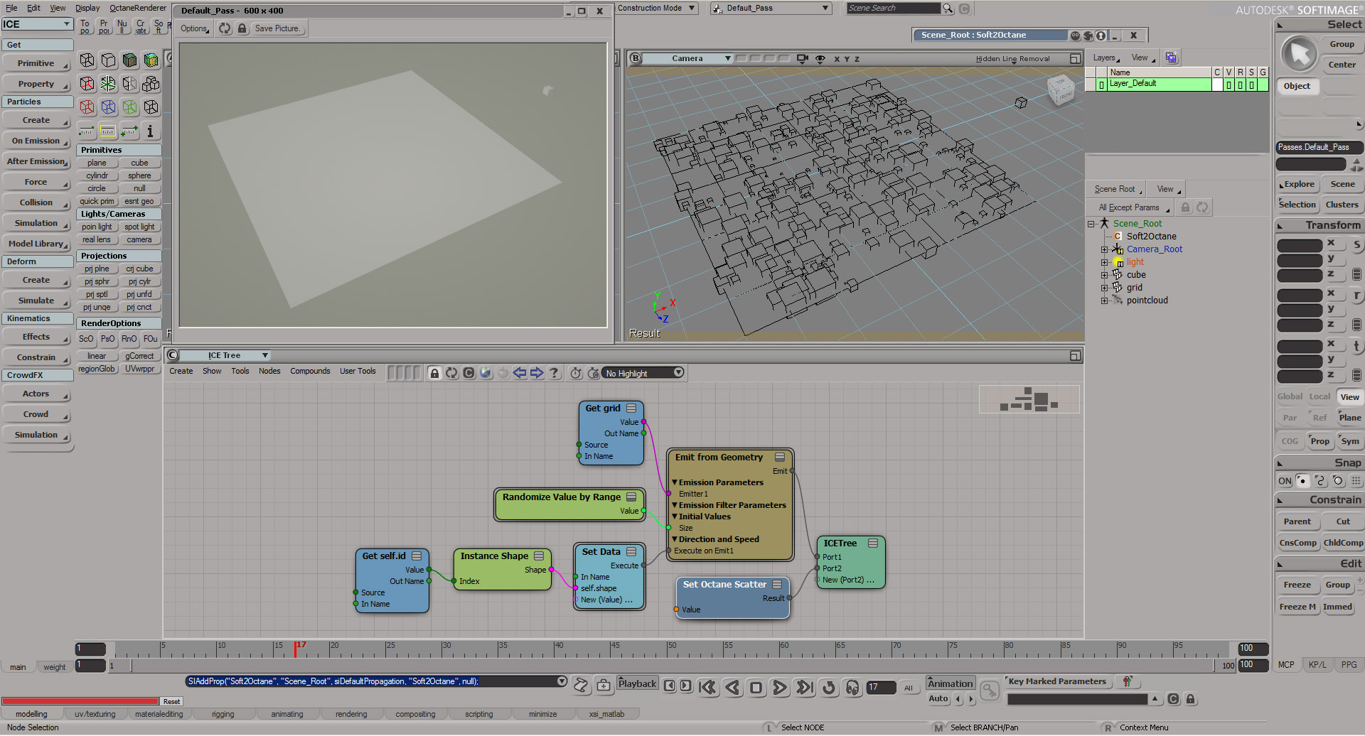

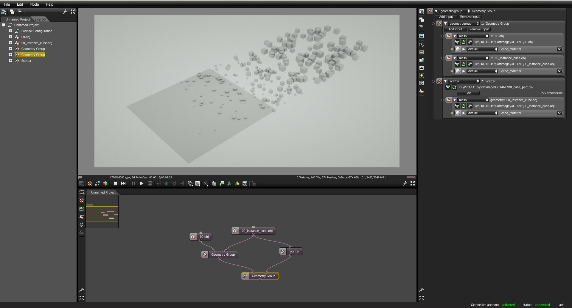

You must create the Octane scene by hand and save they.
After that, there is an option in the export settings where you can type in a mesh/group to render.
There should be the name from the group from the Octane scene.
About the position, the instance shape should be at 0,0,0.
When the shape is on 0,0,0 and the geometry begins at 10,0,0, the output is correct.
To solve this, set the center of the shape to bounding box and recenter the mesh to 0,0,0.
