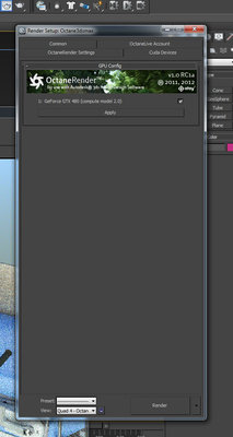

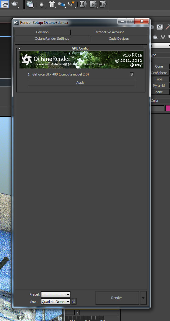

Can you show your GPU dialog in 3dsmax?
freelancah
Posts: 16
Joined: Fri Mar 23, 2012 4:39 am
No I cant atm. I removed the cards since I have a deadline job that I have to finish before monday.. I can test after that probably.
Edit: Well actually I can, because it looks the same with or without the Radeon..Here it is. It looks like this with both cards, just doesn't seem to render.
Karba
Posts: 2300
freelancah wrote:No I cant atm. I removed the cards since I have a deadline job that I have to finish before monday.. I can test after that probably.
Are you sure plugin see GTX480 when Radeon is installed?

I did some further testing and I can no longer see the card in the menu. Last time it was, I'm sure about that, but it looks like this is probably the issue. Will have to test with other PCI-E slots, I used a different one last time. Also just to note, octane standalone still works and sees the card
