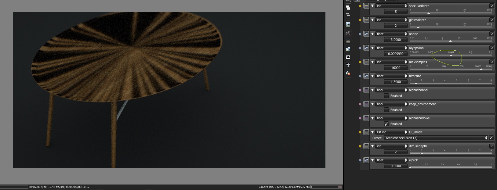

Does anyone know how to get rid of these triangles? They always show up on all my models. It happens when two faces are tangent and when I remove one face,
those triangles show up. :( It really messes up some parts, such as glass, because of the transparency the triangles are visible.
All of my models are converted solidworks parts to step, then with moi3d i convert them to .obj. I tried different export settings already with moi3d. (
This is after and before:

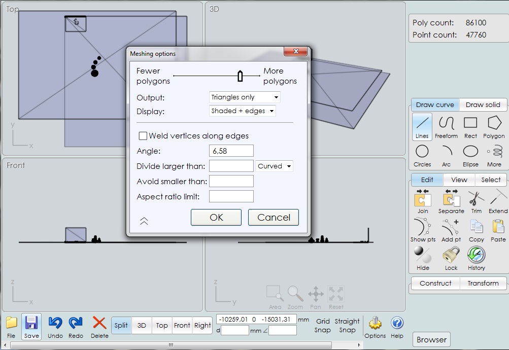

Can you post your .obj file export settings in MoI, or maybe even the original file before export, but with the parts removed?
Martin.
whersmy
Posts: 723
Joined: Thu Aug 30, 2012 7:40 am
Like this? Moi3D always does a good job converting the .step to .obj, but the triangles never go away!
Also here are the .obj import settings.

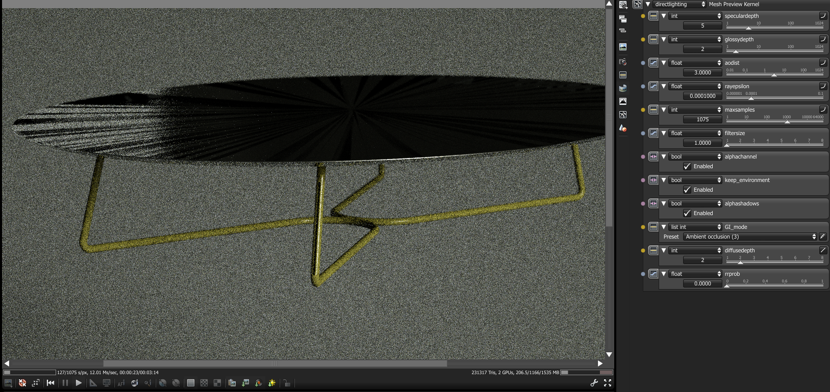

Well, so far no luck. :|
I changed the import settings to meters, but when exporting with moi3d the scale is set to mm`s.
I also tried exporting with weld vertices along edges checked, no improvement.
If i set the scale unit in moi3d to mm, then in Octane its the same right? If i set it to meters in Octane the weird circles show up.
Also tweaking with the ray_epsilon didn`t help, but I did saw the triangles going away, but then the mesh started showing artifacts.
