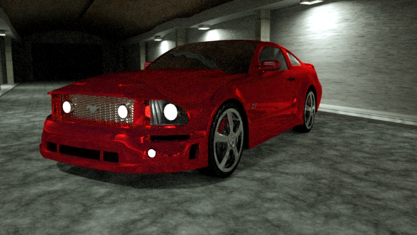

Bought Octane Render for 3ds Max a few days ago. Spent those few days trying to complete a decent render which has been completely unsuccessful. I have gone through every setting Octane has to offer in the last 3 days. I'm frustrated and ready to give up, but maybe i'm doing it all wrong and could use some help.
When I bought Octane render I thought I was going to be able to render photo-realistic images in 1/10 of the time that lets say Vray would take. I haven't found this true in the sense that I can't find photo-realistic settings with Octane, and if I even get close to it, I'm looking at 10 Hour render times and fire flies that would take another 10 hours to clean up! Octane was also only able to Convert about 5% of Vray Materials which was a bummer, but is another story all on its own.
Below I have attached two images that took around the same amount of time to render. Both are originals and have not been touched up.
--OCTANE-- Render Time 2 Hours 1 Minute 1280px by 720px
Max Depth: 8 / Direct Light imp: 0.53 / Exporation_stre: 0.5 / Max rejects: 569
Kernel type: PMC / Max Samples 2500 / FIlter size: 1.5/ rayepsilon: 0.0 / rrprob: 0.0
--VRAY-- Render Time 1 Hour 47 Minutes 1280px by 720px
Image sampler: Adaptive DMC / Anti aliasing filter: Mitchell-Netravali
Primary bounces: Brute Force @ 8 subdivs / Secondary bounces: Light Cache @ 700 Subdivs
Operating System:
Windows 7 64-bit
Mobo: Biostar TA990 FXE
CPU: FX-4100 Overclocked to 4.5Ghz Liquid Cooled
Memory: Overclocked G.Skill Ripjaw 4x4GB
GPU: Nividia Geforce GTS 450 1GB DDR5
.... How can I get Fast Render times that look similar to Vray????
What am I missing here??!
- leblanc980
- Posts: 66
- Joined: Tue Oct 16, 2012 12:25 am
- Location: Chicago, IL
Hello leblanc,
while GTS450 is low-end card (approximetly 1/3 in power of gtx580 which majority of people posting here use) I see problem on material/render settings side. Front lights material is too emissive causing lot of fireflies. Placing few invisible lights (lightbanks) around card could speed up rendering too.
Fireflies tutorial http://render.otoy.com/forum/viewtopic.php?f=21&t=878
Octane can do better than this. If models in scene are free maybe you could you post this scene here so we can check.
i5-2500k | 16GB ram | gtx460 2GB (display) + GTX580 1.5GB | Win7 pro x64 | v1.0 beta 3.00b | http://www.behance.net/petergazo

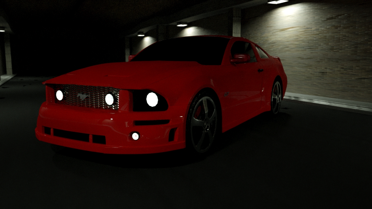

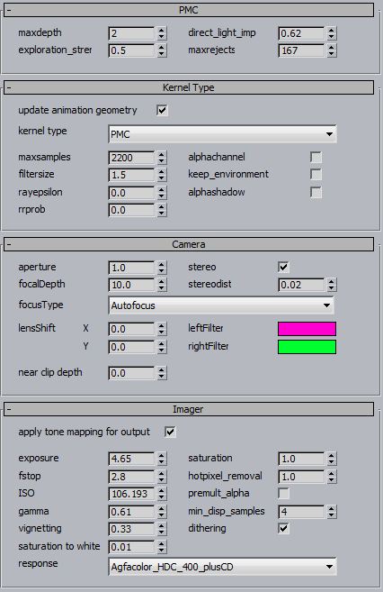

I adjusted a few materials slightly, (Taking some glossiness off of the red car helped out a lot for better realism).
Adjusting the settings and especially taking the maxdepth down from 8 to 2 helped out the most with render time.
I'd like to stay with PMC for final renders, to see what kind of results I can get. But will definitely try the others.
Here is my latest trial, I will also include my settings. Took 27 Mins.
It honestly looks great to me finally. Looks like I could add some more hidden lights to reflect better, but its in the right direction.
I really am thankful for all of your guys input. I really want to nail this thing.
said, could you take a screen shot of your direct light settings?
I hope this topic can actually help people who are looking into purchasing Octane.
Thanks again.
Thanks again.

Hi leblanc,
Check the imager settings, the gamma seems low and therefore it looks like you have pumped up the exposure to compensate?
This is going to make for an extremely contrasted image.
If the scene is too dull with the default values then more lighting is probably a good idea. A texture or daylight environment works very well as additional ambient light, especially for the direct lighting kernel.
Also remove the stereo image tickbox - it doesn't look like you are wanting a stereoscopic render?
Also you might want to reduce the aperture to bring the whole car into focus.
Double check the material on the floor, does it have full specularity and zero roughness? Doing this should help the noise on the floor clean up quicker.
I am noticing for some of the comparison images and said's one that there is no haze of lights on the floor - the roughness may be the reason here.
Lowering the max depth down to 2 will start introducing image quality problems as rays will not bounce around enough to find a light source.
You will start noticing that shadows will be exaggerated causing high contrast.
Cheers
Chris.
