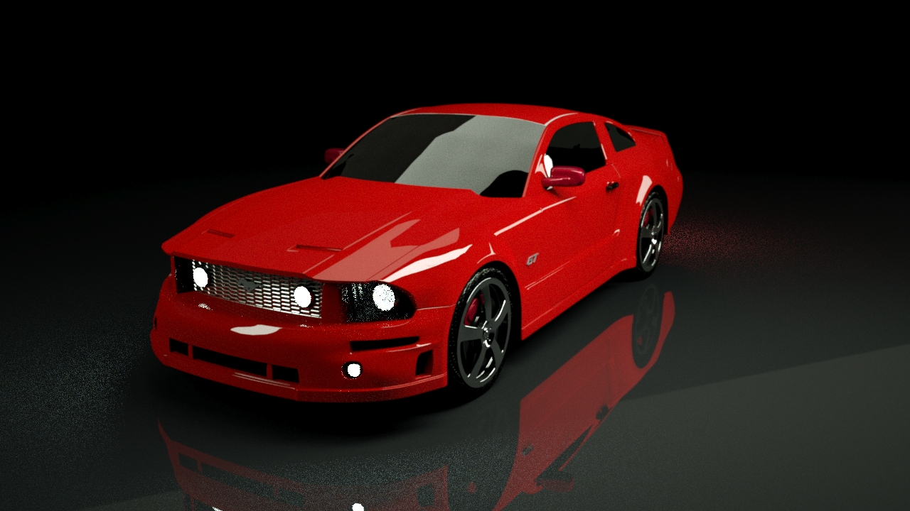

Bought Octane Render for 3ds Max a few days ago. Spent those few days trying to complete a decent render which has been completely unsuccessful. I have gone through every setting Octane has to offer in the last 3 days. I'm frustrated and ready to give up, but maybe i'm doing it all wrong and could use some help.
When I bought Octane render I thought I was going to be able to render photo-realistic images in 1/10 of the time that lets say Vray would take. I haven't found this true in the sense that I can't find photo-realistic settings with Octane, and if I even get close to it, I'm looking at 10 Hour render times and fire flies that would take another 10 hours to clean up! Octane was also only able to Convert about 5% of Vray Materials which was a bummer, but is another story all on its own.

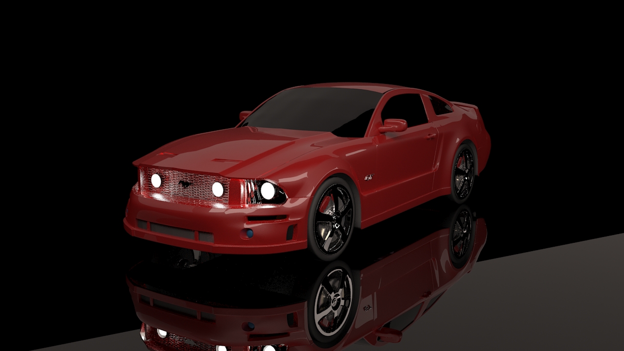

Below I have attached two images that took around the same amount of time to render. Both are originals and have not been touched up.
--OCTANE-- Render Time 2 Hours 1 Minute 1280px by 720px
Max Depth: 8 / Direct Light imp: 0.53 / Exporation_stre: 0.5 / Max rejects: 569
Kernel type: PMC / Max Samples 2500 / FIlter size: 1.5/ rayepsilon: 0.0 / rrprob: 0.0
--VRAY-- Render Time 1 Hour 47 Minutes 1280px by 720px
Image sampler: Adaptive DMC / Anti aliasing filter: Mitchell-Netravali
Primary bounces: Brute Force @ 8 subdivs / Secondary bounces: Light Cache @ 700 Subdivs

.... How can I get Fast Render times that look similar to Vray????
OCTANE Image - Render Time 2 Hours 1 Min.
VRAY Image - Render Time 1 Hour 47 Mins

Hello leblanc,
while GTS450 is low-end card (approximetly 1/3 in power of gtx580 which majority of people posting here use) I see problem on material/render settings side. Front lights material is too emissive causing lot of fireflies. Placing few invisible lights (lightbanks) around card could speed up rendering too.
Fireflies tutorial http://render.otoy.com/forum/viewtopic.php?f=21&t=878
Octane can do better than this. If models in scene are free maybe you could you post this scene here so we can check.
