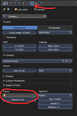

So having used blender for a total of 4 days that means ??? :D :D :D :D :D :D
So use to using Max & CD4 adding a camera is a piece of p..s

It means you go in the camera tab with your camera selected and delete what you have set in the circled field (or put an actual scene object there)

Matej you're my hero :lol: :lol: :lol:
I've searched high & low on Google on how to set up a simple Blender camera & does it tell you that anywhere !!!!!
Gees a totally different workflow & procedure & YES the model shows up in Octane (angelic music starts playing in the background)
