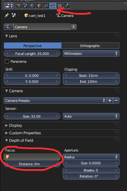

It means you go in the camera tab with your camera selected and delete what you have set in the circled field (or put an actual scene object there)

I've searched high & low on Google on how to set up a simple Blender camera & does it tell you that anywhere !!!!!
Gees a totally different workflow & procedure & YES the model shows up in Octane (angelic music starts playing in the background)

The error message is a bit confusing, but it shows that Lionel (the author of the Blender to Octane exporter) has a sense of humor
