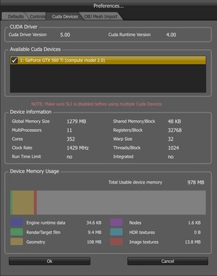

Thank you for the continued assist, but I got nothing...
NVIDIA Info:
NVIDIA System Information report created on: 09/17/2012 10:57:27
System name:
NVIDIA Info:
System name:
Code: Select all
Operating System: Windows 7 Home Premium, 64-bit (Service Pack 1)
DirectX version: 11.0
GPU processor: GeForce GTX 560 Ti
Driver version: 301.42
DirectX support: 11.1
CUDA Cores: 352
Core clock: 732 MHz
Shader clock: 1464 MHz
Memory clock: 1900 MHz (3800 MHz data rate)
Memory interface: 320-bit
Total available graphics memory: 4094 MB
Dedicated video memory: 1279 MB GDDR5
System video memory: 0 MB
Shared system memory: 2815 MB
Video BIOS version: 70.10.2F.00.06
IRQ: 18
Bus: PCI Express x16 Gen2
[Components]
easyDaemonAPIU64.DLL 1.8.15.0 NVIDIA Update Components
WLMerger.exe 1.8.15.0 NVIDIA Update Components
daemonu.exe 1.8.15.0 NVIDIA Update Components
ComUpdatus.exe 1.8.15.0 NVIDIA Update Components
NvUpdtr.dll 1.8.15.0 NVIDIA Update Components
NvUpdt.dll 1.8.15.0 NVIDIA Update Components
nvui.dll 8.17.13.0142 NVIDIA User Experience Driver Component
nvxdsync.exe 8.17.13.0142 NVIDIA User Experience Driver Component
nvxdplcy.dll 8.17.13.0142 NVIDIA User Experience Driver Component
nvxdbat.dll 8.17.13.0142 NVIDIA User Experience Driver Component
nvxdapix.dll 8.17.13.0142 NVIDIA User Experience Driver Component
NVCPL.DLL 8.17.13.0142 NVIDIA User Experience Driver Component
nvCplUIR.dll 3.8.812.0 NVIDIA Control Panel
nvCplUI.exe 4.4.730.0 NVIDIA Control Panel
nvWSS.dll 6.14.13.0142 NVIDIA Workstation Server
nvViTvS.dll 6.14.13.0142 NVIDIA Video Server
NVSTVIEW.EXE 7.17.13.0142 NVIDIA 3D Vision Photo Viewer
NVSTTEST.EXE 7.17.13.0142 NVIDIA 3D Vision Test Application
NVSTRES.DLL 7.17.13.0142 NVIDIA 3D Vision Module (0)
NVMCTRAY.DLL 8.17.13.0142 NVIDIA Media Center Library
nvDispS.dll 6.14.13.0142 NVIDIA Display Server
PhysX 09.12.0604 NVIDIA PhysX
NVCUDA.DLL 8.17.13.0142 NVIDIA CUDA 4.2.1 driver
nvGameS.dll 6.14.13.0142 NVIDIA 3D Settings Server
Athlon II x4 2.8ghz | 6gig | GTX 560 TI 1.25g
- Starrigger
- Posts: 12
- Joined: Fri Sep 14, 2012 2:03 pm
here is some added information, I let Octane just sit there for awhile and FAILED showed up in the lower right hand corner, so that now it reads:
0 Tris, GeForce 560 Ti (failed), -/-/1279 MB
