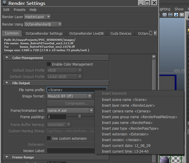

Slimshader
Posts: 92
Joined: Fri Sep 03, 2010 2:17 am
Location: Canada
Sounds good to me.
The plugin is getting better and better.
Batch rendering has become really stable, however I have been rendering sequences through the render view still.
When I batch render, if I use any of the File name prefix presets in render settings, my rendered files are re-named to the name of the scene temp file. (the scene file that gets saved after a batch render is started)
This messes up links to cached data and changes my naming conventions as well. :?
It doesn't happen when I leave that field alone or if I batch render through renderview.
