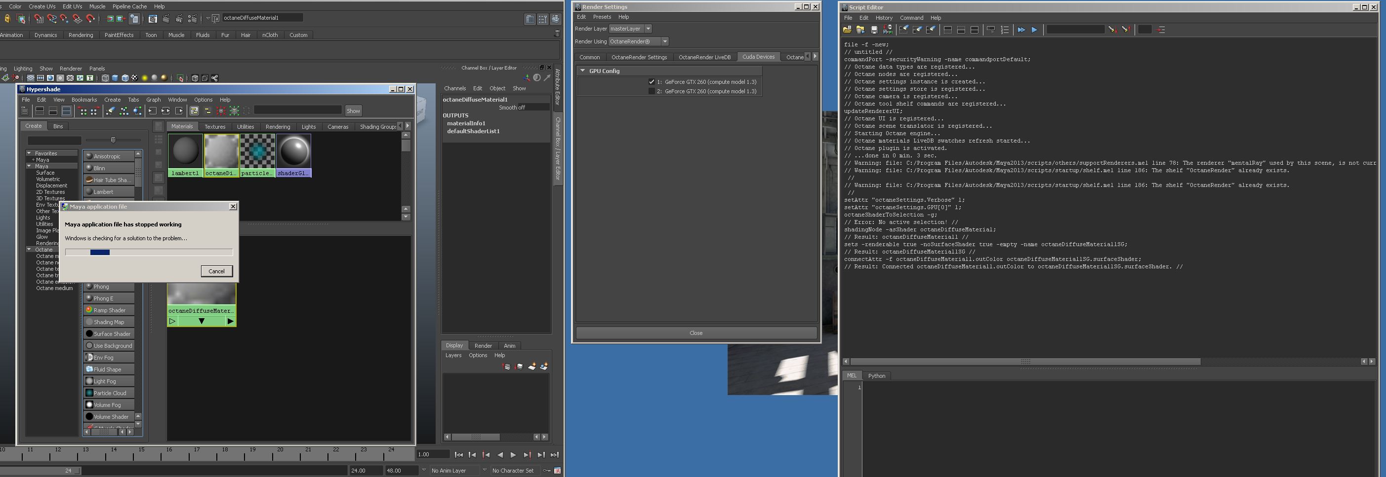

What will be helpful too: all Octane messages that appear in Maya's script editor may be helpful (these during Octane plugin loading too). You may also try to do that way: before opening the Hypershader, enable "Verbose mode" in Octane render settings, open Maya script editor window, and then let Maya to this crash, and after Maya's message about crash appears - make the screenshot of the script editor messages area content.

Here is a screen grab at the time of crash, I turned on Verbose mode - does that generate a file? not much data here Im afraid....

Thank you! Very helpful screenshot!
I will analyse this info some time, will be back tomorrow (it is already night here)...
I already see some warnings that usually do not appear when Octane works. And I see that the preview material balls perhaps are not the reason of the crash - they are started to render, and rendered well in the first "low res pass"... I think something other just stopped the preview balls render process after first pass was already succeeded...
