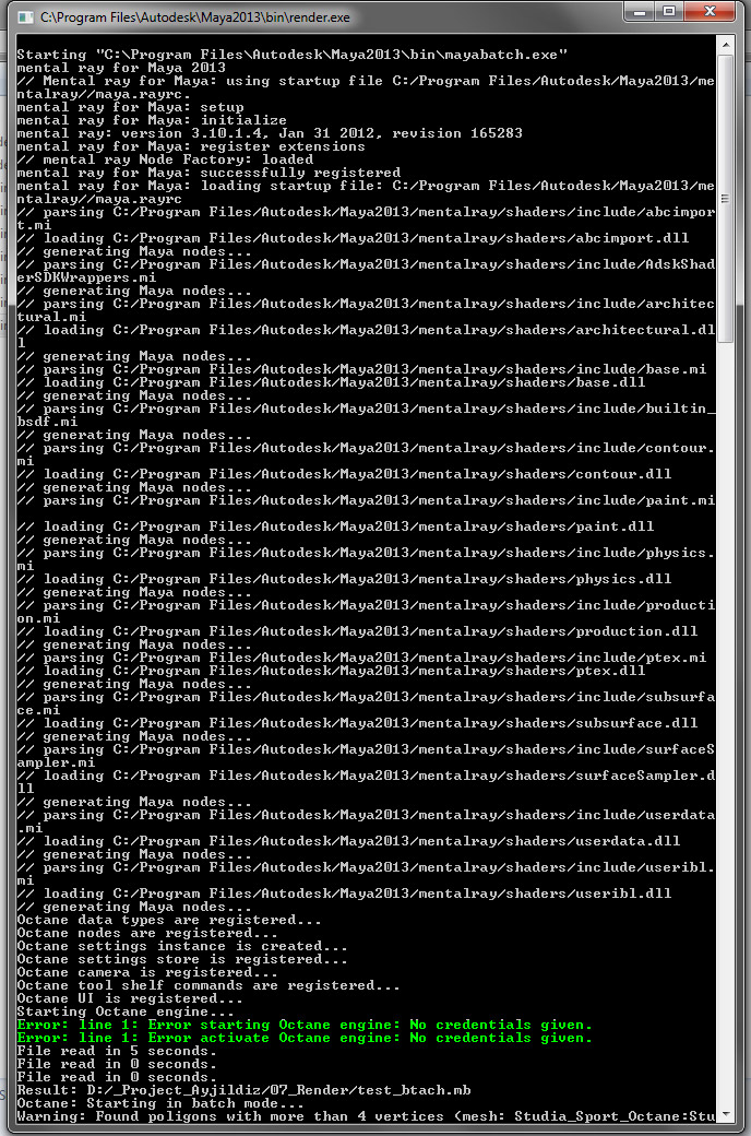

Now i have some problems with Batch render. If i hit batche render from Maya it ok, but if I click right mouse button on maya file and hit render then I get this message :
Sorry for my poor English

ZLOy wrote:Now i have some problems with Batch render. If i hit batche render from Maya it ok, but if I click right mouse button on maya file and hit render then I get this message :
As I see on your previous screenshots, you worked in Maya 2012 x64. But in your windows shell menu is registered Maya 2013 x64 (this version of Maya was started by windows on your computer when you choose "Render" from shell menu). You have entered your login-password for Octane for Maya 2012 x64, but you have not registered Octane in Maya 2013 x64.
So, you have two ways:
- register (enter login-pass) Octane in Maya 2013 x64 too, or:
- register Maya 2012 x64 for windows shell menu
Oops))..Thanks, I`ll just uninstall 2013. :lol:
