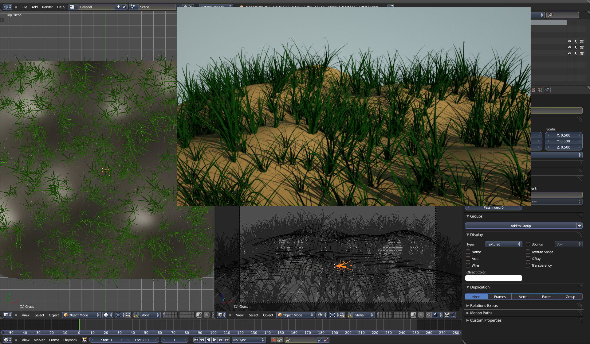

Grass done with hair PS

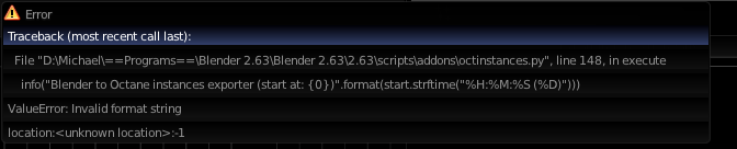

I think iv done everything correctly, I'm getting this error
Win8 Pro 64bit ULT|Intel Core i7 3930K|3.20 GHz|32 GB RAM|GTX 590|UD5 2011 socket||2x TB HD||Master Cooler HAF X||Blender 2.6||Maya 2012||Octane|
matej
Posts: 2083
Joined: Fri Jun 25, 2010 7:54 pm
Location: Slovenia
Hm, dunno. Must be some locale thing. I've updated the download with those parts commented, cause they are really not important. Try it now.

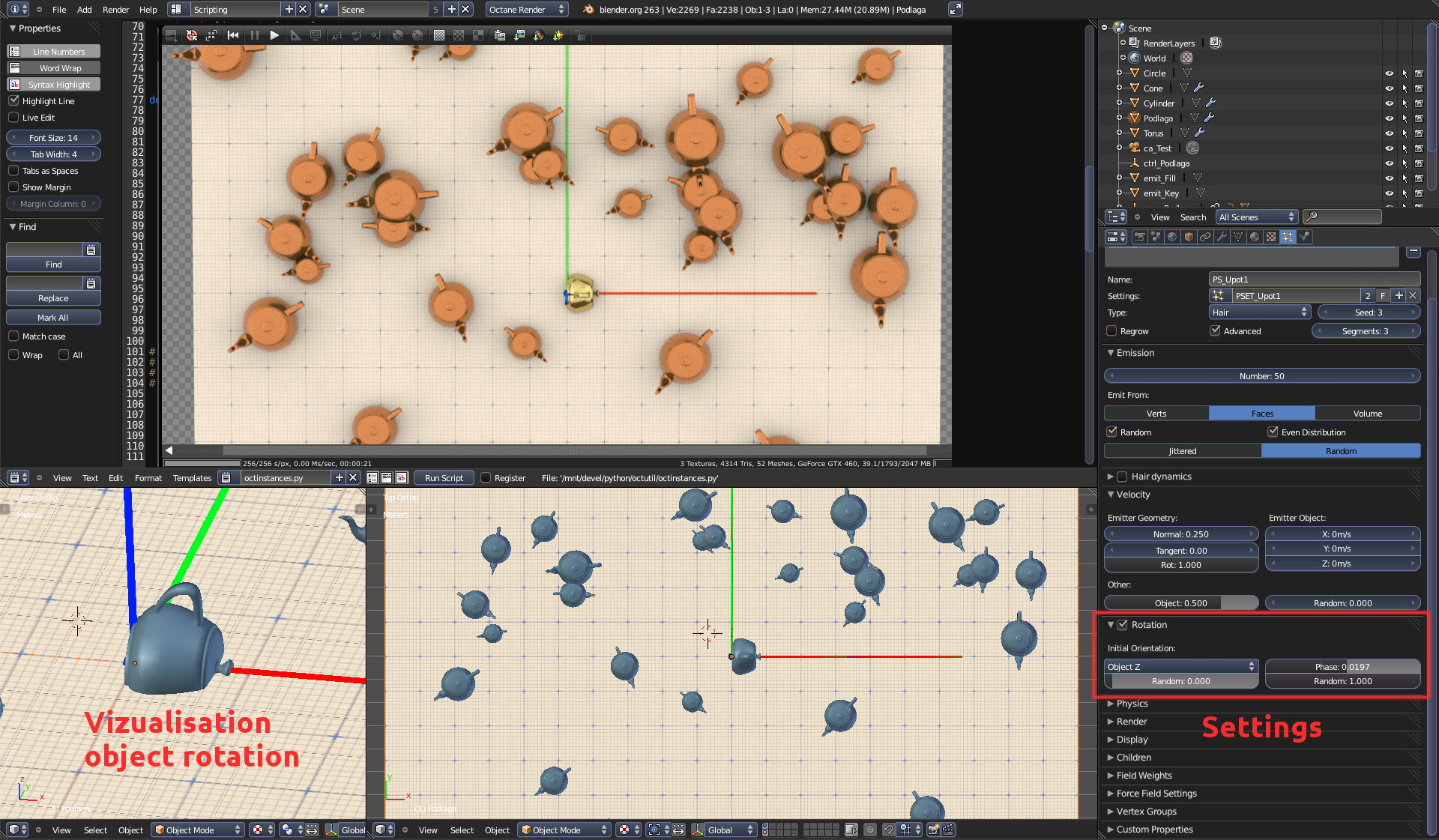

Hi matej. I tried your script and it works nicely:) Excellent work. Can you please tell me if is it possible to achieve random Z rotation with you script? That would be very usefull for trees and vegetation.
Cheers,
n1k
[email protected], 8gb RAM, Gainward GF 460 GTX 2048mb,Win7 64bit.
http://continuum3d.blogspot.com/
pixelrush
Posts: 1618
Joined: Mon Jan 11, 2010 7:11 pm
Location: Nelson, New Zealand
Thanks man 8-)
i7-3820 @4.3Ghz | 24gb | Win7pro-64
GTS 250 display + 2 x GTX 780 cuda| driver 331.65
Octane v1.55
matej
Posts: 2083
Location: Slovenia
n1k wrote:Hi matej. I tried your script and it works nicely:) Excellent work. Can you please tell me if is it possible to achieve random Z rotation with you script? That would be very usefull for trees and vegetation.
Yes, though the setup is a bit contrived. The script just tries to match the transforms from Blender as best as possible, so the trick lies in Blender. To achieve particle rotation around their local Z you must first rotate the source visualization object around Y (look at the teapot at the coordinate center - the one that has its rear up) and set the initial rotation to Object Z (Global Z, Velocity/Hair or Normal can also work) in the rotation panel of the particle settings. Then tweak phase & random. Dunno why exactly you need to rotate the source object, but this is how it works. :) If anyone knows a simpler solution, please share.
I noticed that if the emitter is rotated, the individual particle rotations are a bit off (but translation & scaling of the emitter works right). Well, the script is still rudimentary and particle rotations are a bit tricky matter.

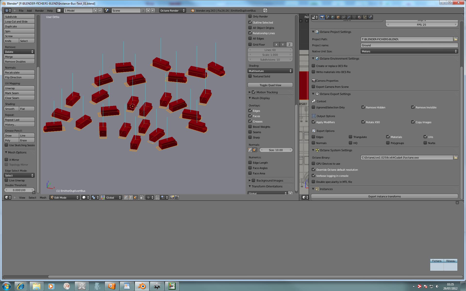

@n1k : I put a screen shot of Blender for you :
Just create a mesh made of separate faces that will support your Dupliverted trees, and rotate the faces to place the trees at your convenience. If the scen contains many heavy objects, just use a simple object as template to speed up the process in the 3D view, like my red bus template which is almost a cube.
A BIG THANK YOU Matej ! :)
