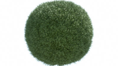

Here is a little test that I did last night. 1.5 billion verts, very good.

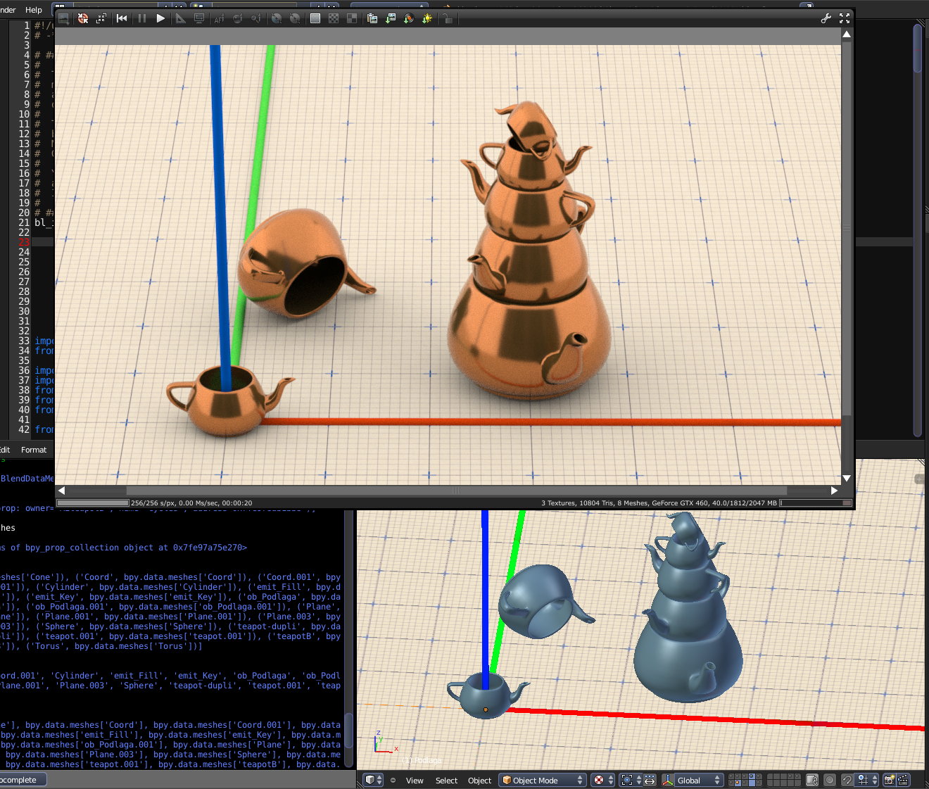

* Added support for Alt+D duplicated mesh objects.
Now you can Alt+D duplicate your objects and if you export transforms when you have one (any-one) of those objects selected, it will export the transforms of all the objects that share that mesh (in simpler words: Alt+D your objects, select one of them, hit export :)).
You must note that its impossible to represent a group of mesh-linked objects with instances, if the objects have different modifiers / same modifiers with different parameters / same modifiers differently stacked... anything that results in a different mesh if you apply all the modifiers. Octane only works with finally transformed (modifier applied) raw mesh data, so even if those object share the same identical mesh in Blender, they are different when exported to Octane.
Thus the script assumes all the objects have the same modifier stack and does not do any verifying on this, so it's up to the user to pay attention to this rule. You can of course transform (scale / rotate / translate) your objects at will. When you hit "export transforms", the script will take the active selected object and its modifiers as the base mesh for all the others. The filenames (.csv/.obj/.mtl) will get the name of the mesh datablock (because is unique), so pay attention to name your datablocks accordingly, or else you'll end up with confusing "Cube.001" stuff. (it's always good practice to nicely name your objects :)) Also pay attention to not export them together with the rest of the scene, else they will appear twice in Octane.
So, if you have a bunch of rigid objects (Octane instances are meant to be just basic uniform transforms, nothing advanced), you can now export them as instances and do anything to them that doesn't affect their final mesh, like animating etc... Should work greatly for trees, cars, furniture & similar hi-poly stuff that you would place around manually. No need to use duplifaces anymore.

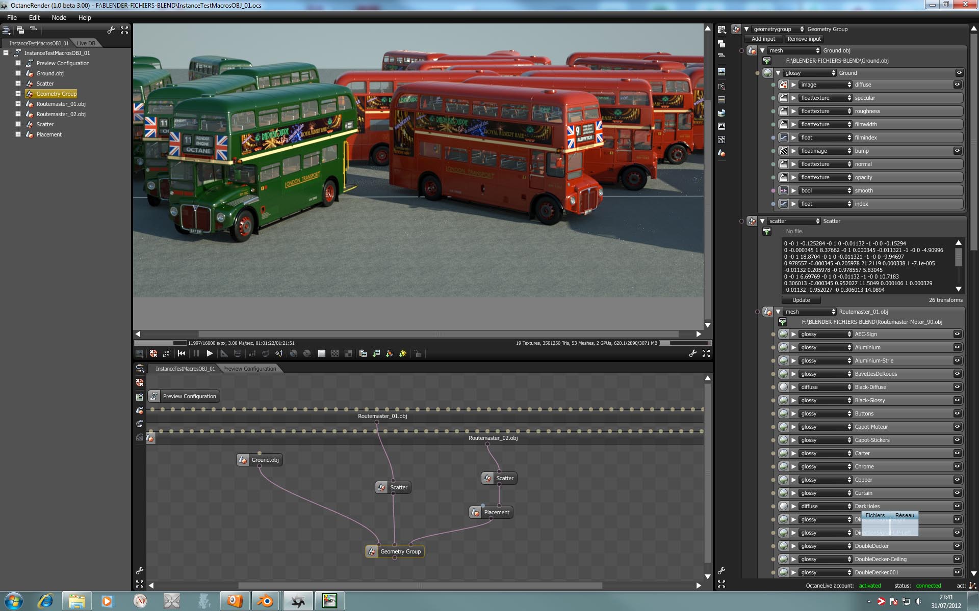

Below, an example of very interesting possibilities : textures and materials variations using Instances.
It may seem obvious for most of you, but as I am not used to these features as well as I rarely used nodes in Octane, I have just discovered that by just renaming an obj node, customized versions of an object like a vehicle are possible.
It is easy to change colors and textures. You can make a texture with several ID plates for example for each car, or even change the stickers on the cars using one geometry only.
I would have never thought that instances could be so polyvalent !
It is my best day for a while ! :)

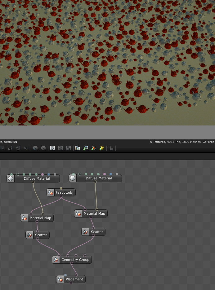

@Roubal, you can use the material map node, for varying materials of the same .obj mesh, but different scatter group. Material map will override the material you plug-in into the .obj node:
In reality node systems are more intuitive, easier to follow & more powerful than "classic" approach to shading. You'll be missing some functionality if you don't learn nodes.
btw, in the last update I forgot to put render-ability checking for mesh-dupli objects. So right now all of the transforms get exported, even if the object is not visible for rendering or not on active layers. Will correct in the next update.
