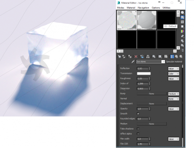

No caustics on your image. - But... seems be not real...
Look... my work about ice stone and I tested to render... but HAVE caustics!! Sorry, I haven't snow material. ;)
Sun size 9x is +/- equal to you. ;)
PMC settings:
- 3k-sample/px at 9 minutes
- 27-maxdepth
- 5k-reject
- paralellism 1
- without "caustic blur"
Do you like my image? :)

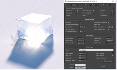

No, PT is less efficient than PMC for caustics.
Screenshot
Looks noises colored in caustics. 4500 kS/pixel at 9 minutes.
PMC is still better! :)
prehabitat wrote:What just happened?
Who won? :)
Martin used PT settings: maxdepth diff 6 and spec 8; caustic blur 0.2; GI clamp 10. These settings are incorrects.
I won but caustics only. :)
