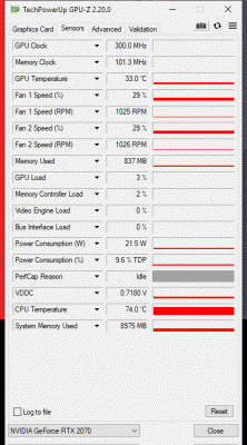

I posted the GPU temperature when rendering:

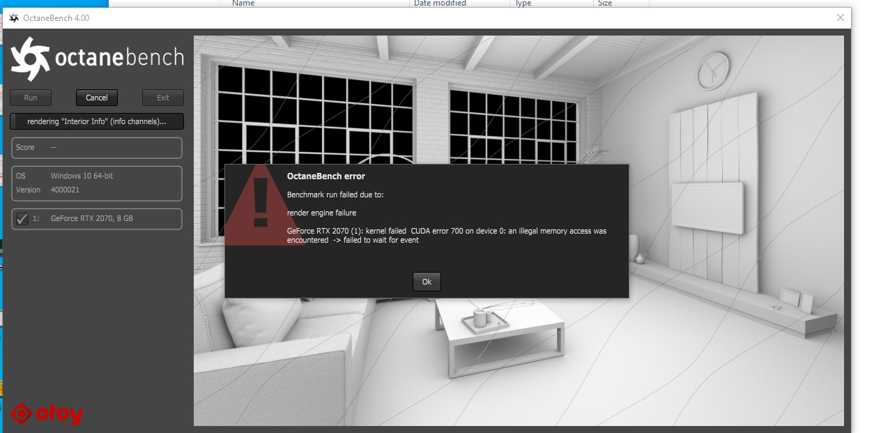

I did all those steps, updated windows, resinstalled Nvidia from scratch, Octane 4.05 on Cinema4D R20.59 and this is what i got
Posts: 10654
Normally the previous steps should have solved the Nvidia driver issue, unless the GPU is overclocked, or corrupted.
