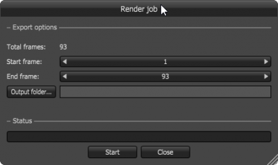

The frame settings in a render job dialog is the total result frames of the render job(not animation frames), this is allowing us to render sub sections or to restart from where we stopped.
And will not make more sense, if it is inside the render job graph itself.
Current render job dialog
Please let me know, What do you prefer or you have any new suggestions?

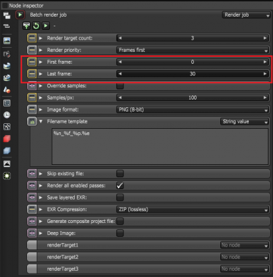

Hi calus,
We do have animation frame settings in the render job node and will add output folder option to the node as well.
Once we complete rendering of multiple render job feature . You can render different render targets with a different animation frame range in a single go/button.

vijay_thirukonda wrote:We do have animation frame settings in the render job node and will add output folder option to the node as well.
Yes this is a frame range override for all render targets in the render job,
my point is :
because of a design flaw in Octane (missing frame range per render target),
we finally end up with the "multiple render job feature", maybe an over-complicated solution.
A simpler solution might be to fix the design adding frame range attribute to the animation node.

Also please change the default filename template to something actually usable,
The frame tag %f must always be at the end of the name (before extension), not the pass tag %p,
else the image sequence is not readable by any software :shock:
(Yes I know this is the same default template as in the batch render script,
should also be changed there :) )

calus wrote:Also please change the default filename template to something actually usable,
we changed the default filename template in release 3.04.3

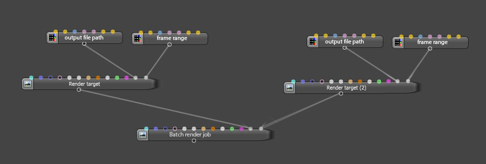

I already suggested something like this:
But it doesn't have to be that way, it is just a suggestion. My point is that we have to define output and frame range much earlier in the workflow, and that will allow to run multiple render target jobs at once.
In production (and believe me, I'm 10+ years in it), current system is not flexible at all. It has to be!!! Flexibility is the most important parameter, so ability to define multiple parameters at once is big advantage too. Standalone is nodal and what is the point not to use that advantage?
When doing this render job system, you have to think that way.
What is important:
1. Flexibility
2. Simplicity
3. Overrides.
And common workflow goes this order:
1. Define render parameters/settings for each render target
2. Define frame ranges
3. Define output paths
4. Define file types
5. Hit render
First 3 stages are unique parameters for each render target/pass/layer call it as you want. When you define unique parameters, then we connect further to the render job where parameters are common for all render jobs. And that means file types, skipping rendered, compression, overall frame range override... etc. It is not acceptable to choose if render is tonemapped or not at this stage. Render job has to respect "Camera Imager" decisions. What if I want one render target to be tonemapped and other not? So, render job parameters have to be common for all render targets, it has to be simple, it has to have checkboxes to select render targets that will be rendered, and one big "RENDER ALL/SELECTED" button. Hit it and go to pub. :-)
Maybe, I missed something, but I believe that something similar to this kind of workflow will make life easier to all.
